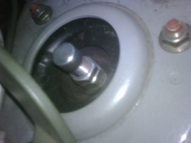

Just installed my front D-Specs last night. According to the instructions, each front strut comes with a "front piston rod (shaft) top nut" (12mm). These do fit on the end of the piston rod (the part that is in the engine bay), but they don't seem to serve a purpose, and the protection caps don't really fit if the nuts are installed. Just to be clear, I did install the 17mm shaft nut that keeps the top spring seat on.
So the question is, are these needed?

The shaft has two diameters, the bottom part fits the stock 17mm nut, and the top fits a 14mm. The cap doesn't really fit if there is a nut on the top part, and again, I don't see what having a nut on the top would do. The instructions are crap.

Old Feb 14, 2010 | 10:26 PM
OCG35's Avatar
iTrader: (33)
Joined: Nov 2004
Posts: 17,181
Likes: 154
From: OC - So Cal
ditch that top nut and screw the cap on - you'll be good to go.
Old Feb 15, 2010 | 10:57 AM
brandon1978's Avatar
Posts: 382
Likes: 13
From: Austin, TX
That is what I did. I wasn't really worried, just curious what Tokico was thinking by including those nuts.

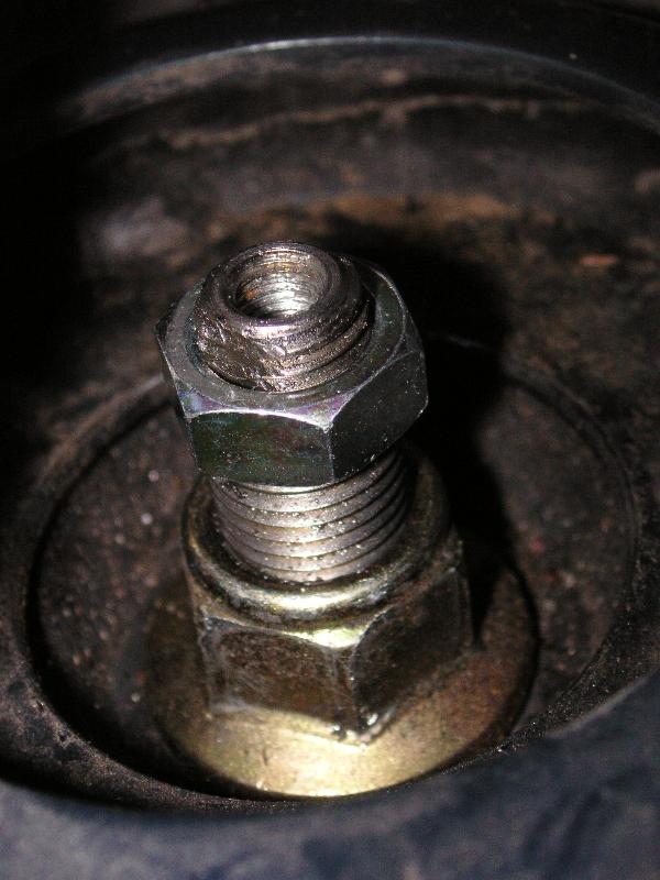

let me check tonight.. Cause i know i used 2 nuts they supplied for the shaft in the rear or the front and ditched the stock one. Unless i f'ed up and install it all wrong. But i have no problems.

Old Feb 15, 2010 | 09:01 PM
SuperStezzyG's Avatar
Joined: Jan 2009
Posts: 508
From: cali
my fronts..
