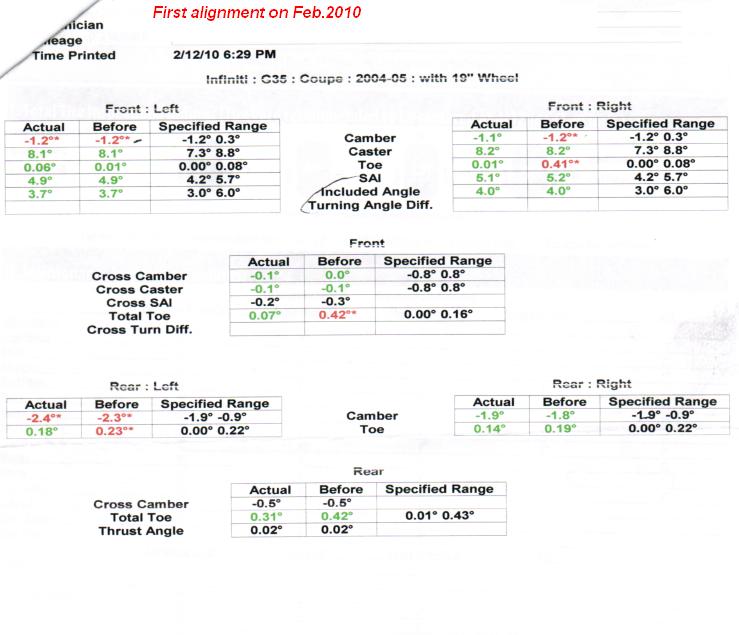

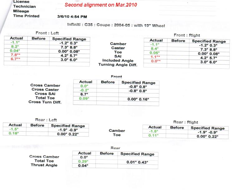

Here is both alignments where I just don’t understate what is going on with SAI and Included Angle why is so perfect on the first one and then is so off. But my biggest concern is the tires. Thank you guys, anything will help.

SAI is not adjustable. I would bet the tech just didn't setup the equipment right to check SAI. The Included Angle is just SAI plus camber. The machine doesn't measure Included Angle, it just does the math. I'd be more concerned with your rear toe and why they are so different from each other. Both of them being in spec isn't good enough, they should be equal or at least within .01° of each other. There was a service bulliten for this issue on the 2003 models. I believe the solution was to set front toe at max in (.08°). You can also take the tires off the wheels and swap them side to side. That way the worn inside edge will get moved to the outside edge.

Just looked at your first alignment sheet again...your right front toe was five times higher than the max spec!
