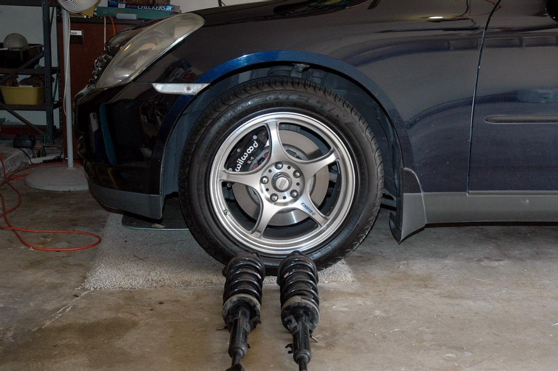

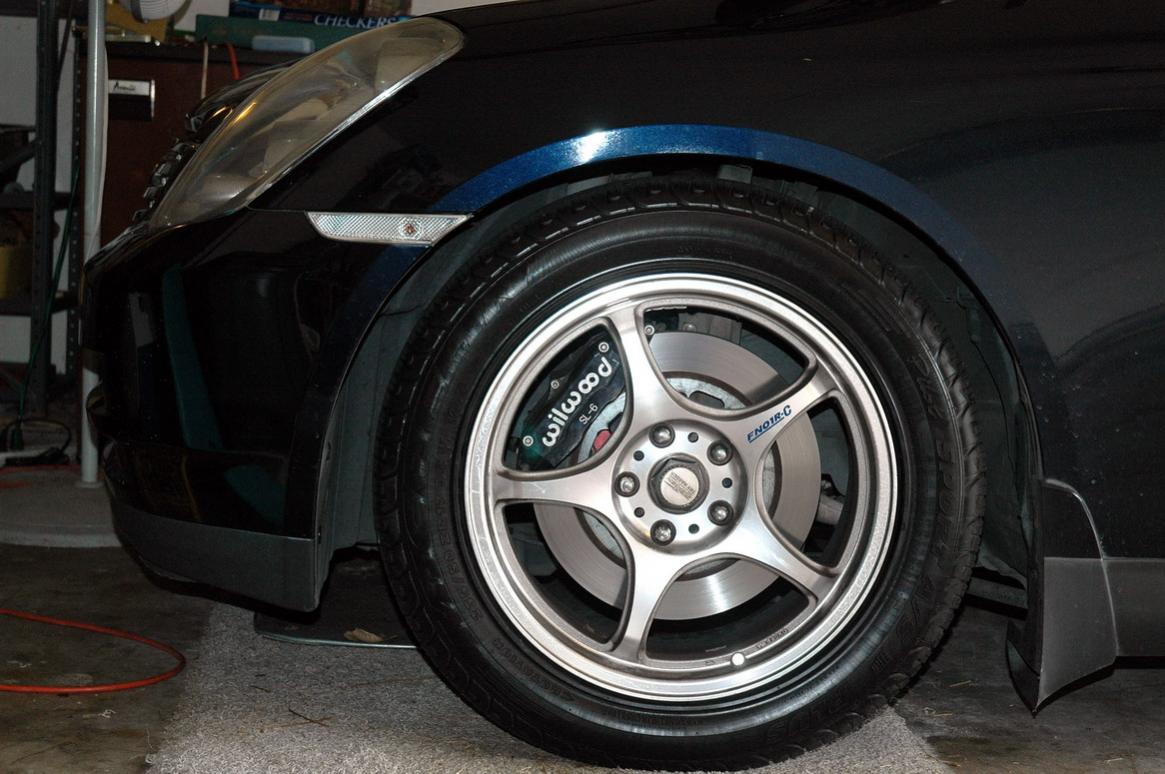

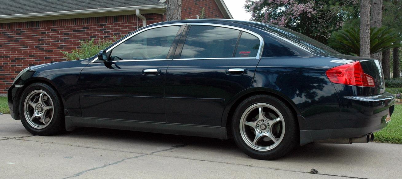

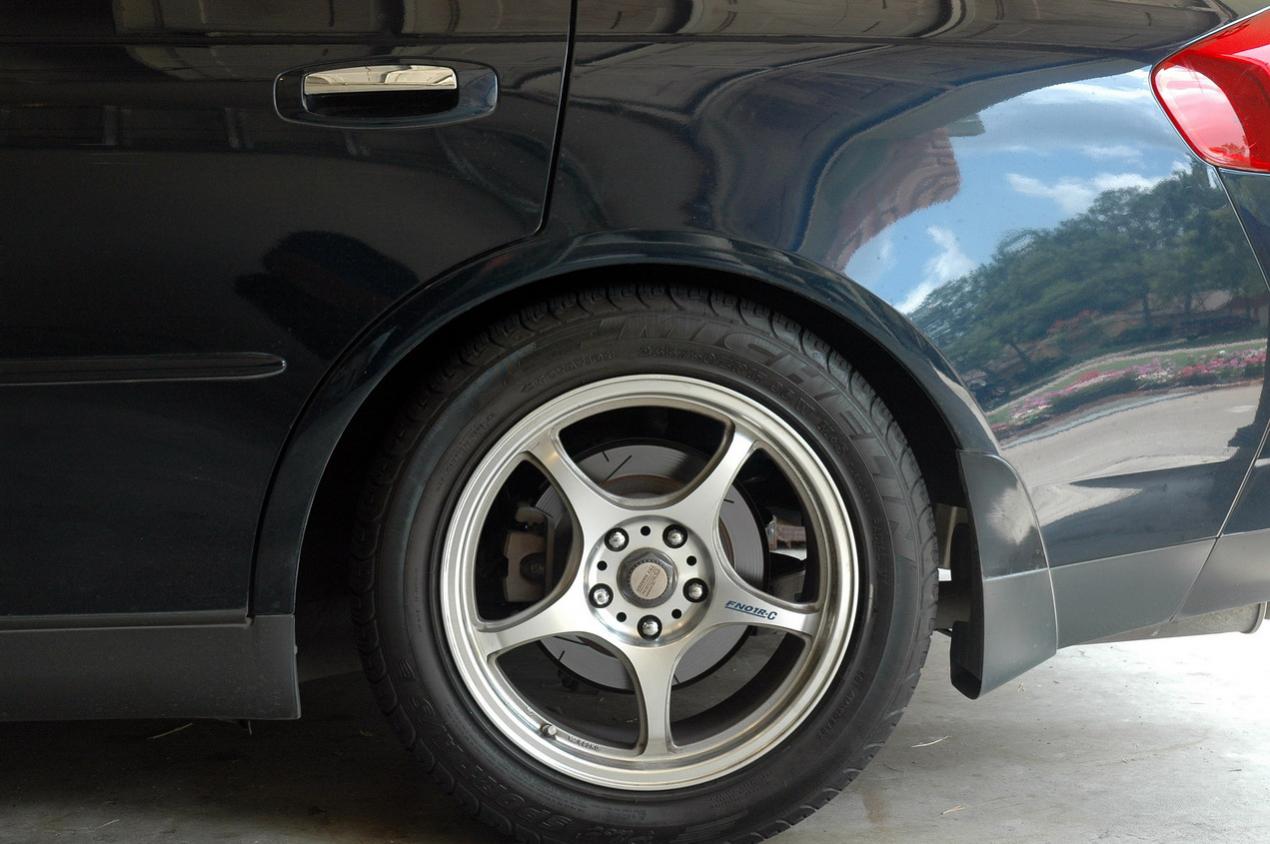

My steering wheel was bouncing all over the place so I decided to have the front wheels rebalanced. No change in bounce after the re-balance. So I took it back to NTB and asked, WTF? The advisor looked at the front tires, Michelin Pilot A/S+, and noticed they were cupped, indicating the front struts needed replacing. So I took the opportunity to replace my Sedan Sport suspension with a revised 350Z suspension. The drop is fantastic! Pics attached:
-----------Stock--------------w/350Z-----------------stock----------------w/350z--------------------results
Attached Thumbnails Worn out suspension replaced w 350z suspension-front_w_struts_resized1.jpg   Worn out suspension replaced w 350z suspension-frontw350zsuspension-resized.jpg   Worn out suspension replaced w 350z suspension-rear_springs-shocks_resized1.jpg   Worn out suspension replaced w 350z suspension-rearw350zsuspensionresized.jpg   Worn out suspension replaced w 350z suspension-sedanw350zsuspensionresized.jpg

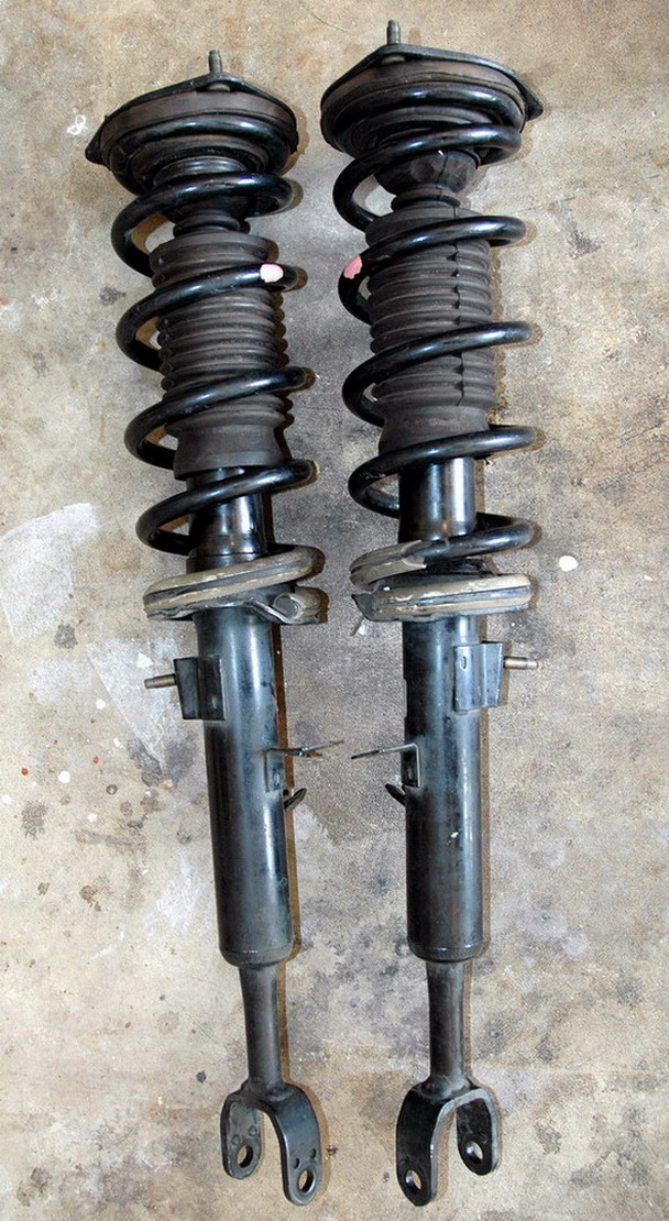

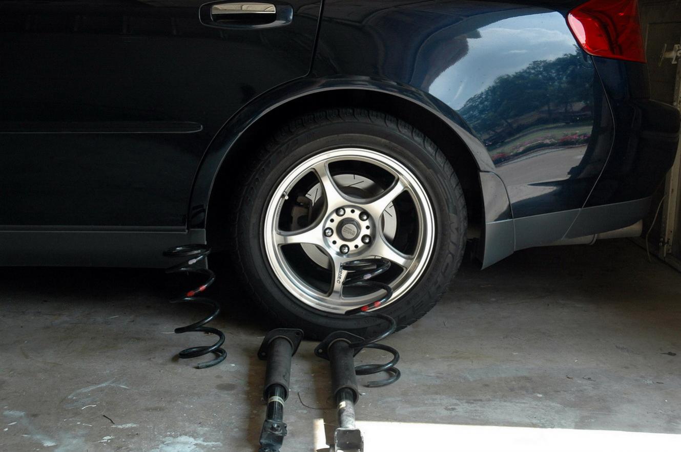

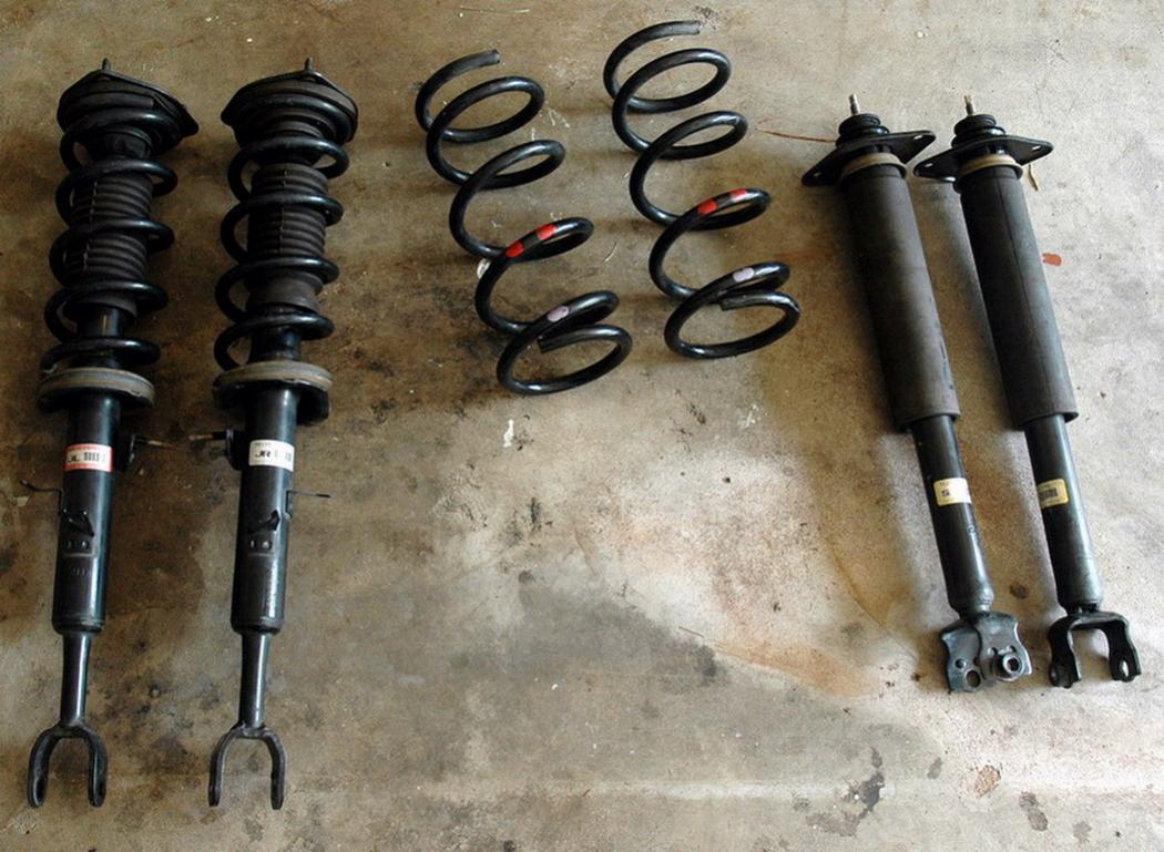

Replaced with a revised 2005 350Z suspension with 23K miles.
Attached Thumbnails Worn out suspension replaced w 350z suspension-dsc_6615shrpresized.jpg   Worn out suspension replaced w 350z suspension-dsc_6616shrpresized.jpg   Worn out suspension replaced w 350z suspension-shocks_resized.jpg   Worn out suspension replaced w 350z suspension-springs_resized.jpg

Tire cupping is not a indicaton of shock perforance or shock wear. It is a sign of incorrect alignment setttings. Add high caster and directional tires to the mix and that doesn't help much.

A revised oem Z suspension is a cost effective way to get a 1" drop on a sedan and better control. D-specs set to 3 or 4 above full soft will offer simular control, but better ride quality because of better valving.
And always ALWAYS avoid unrevised oem 350Z shocks at ALL costs, otherwise bounce and freeway porposing with be very much a part of everday life.

They were bad for the Z and suffer from the same issues on the sedan, read on.
My very first suspension mod was a 2003 oem 350Z shock and spring setup (unrevised). Turn in was fantastic, brake dive and squat were much better. Ride quality was awfull. I should have paid attention to the Z owners that were complaining about bounce and freeway porposing. My car had the problem big time. IIRC I went with Koni's after that.
Nissan revised the shocks for very valid reason's. Koni also did their valving differently, likewise for very valid reasons. With revised shocks consistently showing up for resale and with the avalibility of rather cheap Tokico HP shocks. It makes no sense what so ever to pay money to punish yourself.
