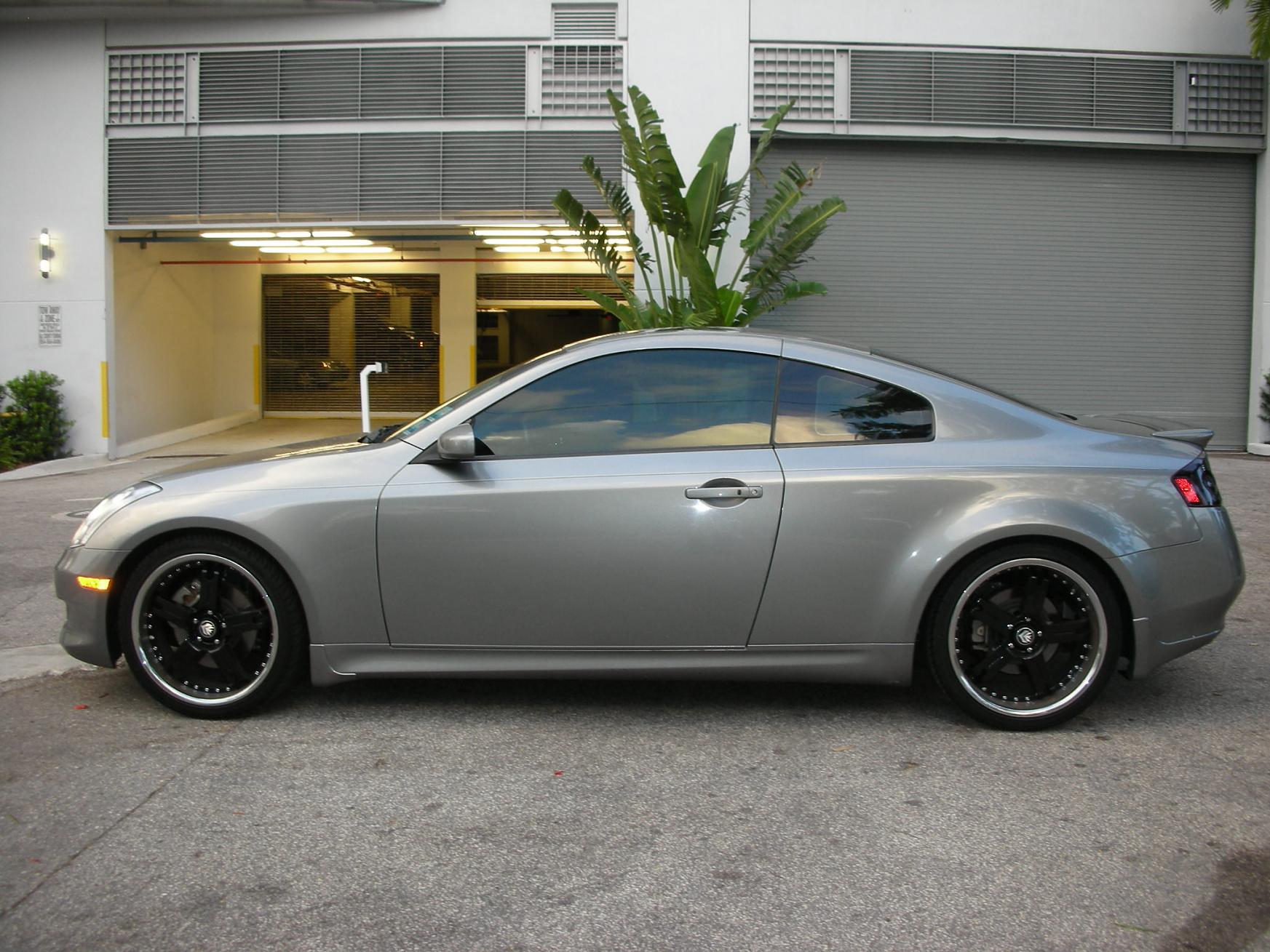

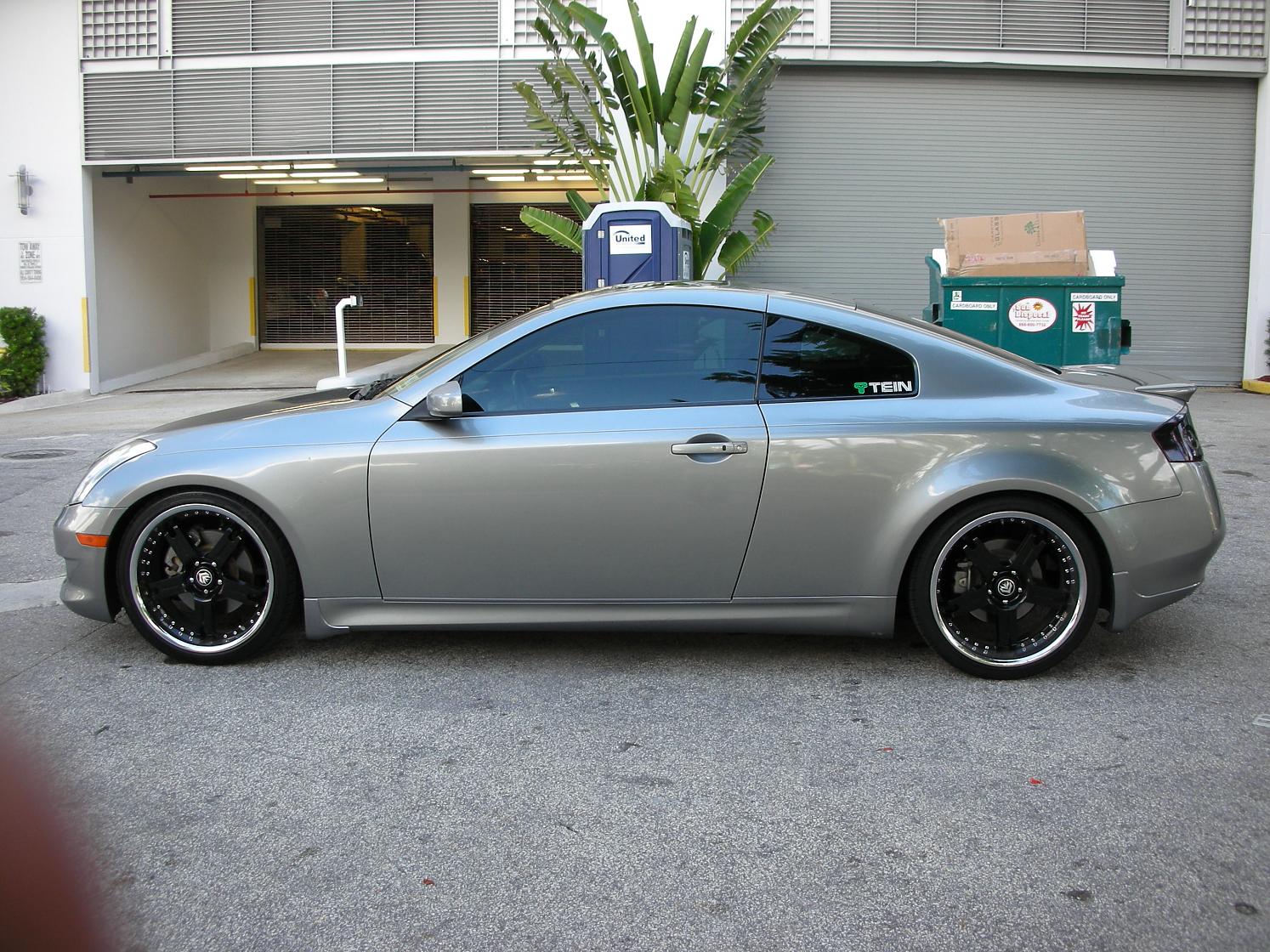

In any case, some of the data I looked at is below, along with before & after pics.
And if you want more, let me know so you can do your own comparisons. For the most bpart I eventually narrowed down my choices to Tanabes or Teins - about several variations, I think (Tein S-techs or H-techs, Tanabe GF210s, NF210s or DF210s, for G's or 350z's)
