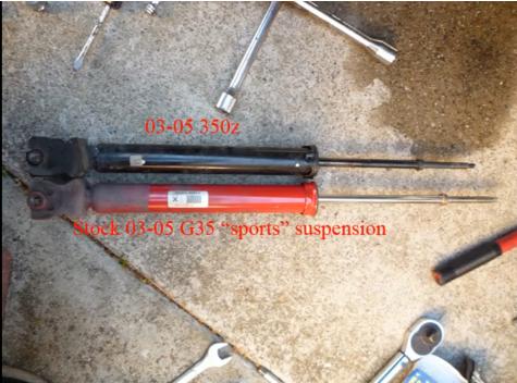

Guys, I want you to look at this.
The piston of the Z shocks is 1.5" shorter than the sport sedan shock in the rear.
I don't have time to explain this yet, but please take note of the difference in bumpstops being used, and the amount of compression permitted before bottoming out.
See attachment.
Old Jan 18, 2011 | 04:32 PM
  #28
High_Boost's Avatar
Joined: Dec 2010
Posts: 88
interesting, so the body is the same, just a shorter piston.. I wondered about that
it would seem to me that with lowered springs the shorter piston would be better (assuming you arent topping out the shock), but I have read posts claiming the Z shocks make the G drive like crap.. maybe cutting the bumpstop would fix that
Old Jan 18, 2011 | 06:00 PM
  #29
tyau's Avatar
Joined: May 2008
Posts: 155
Yes. The z shocks would lose significant travel if paired with the g35 bumpstops when using the z springs. I have reasons to believe that people who are not getting the full 1" drop at the rear are riding on the bumpstops. When the weight if the car sits on the shocks, the stock rear suspension only has a little over an inch of compression in the shocks. If you lower your car one inch you lose that compression unless the bumpstops are trimmed or a Z part is used
