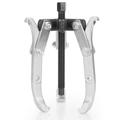

i'm having this exact same problem as we speak and im gonna try some of the methods you suggested but how did you get that metal ring out of the compression rod its self, I didn't want to risk prying it out with a screw driver and mess up the rod. Any suggestions

^ I used a gear puller that I rented from AutoZone to pull the bushing out of the compresson rod. It takes a couple of tons of force to remove the oem bushing, so your not gonna have much luck with a screwdriver. I did this initally hoping that the puller would apply enough downward force to break the rust free, but my inner bushing was so rusted that the whole thing slipped out of the compression rod.
This is what I rented:
I attached the puller arms to the top edges of the compresson rod, and used the threaded stud on the car body to pull the bushing out. It was pretty sketchy because the arms kept slipping off and I had to re-adjust the gear puller many times. Be very careful if you attempt this. If you apply to much force sideways you risk snapping that stud attached to the body.

Guys this article was a savior. I did the exact same procedure after hitting the arm to the body of the car was not working nor pb blaster. Also ended up using a grinder to the ripped bushing after using a 6" puller to it.
