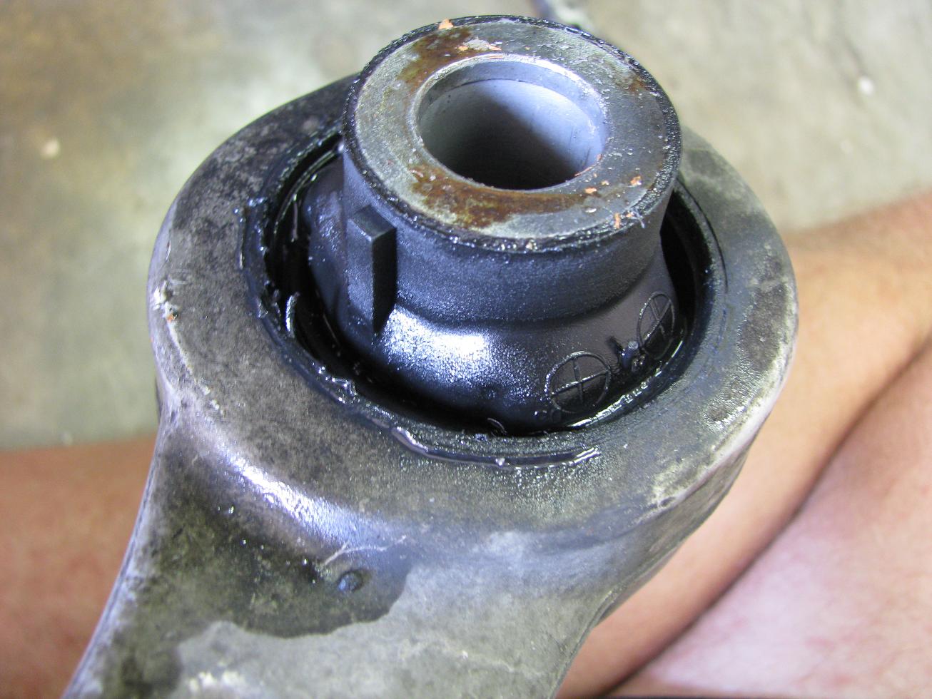

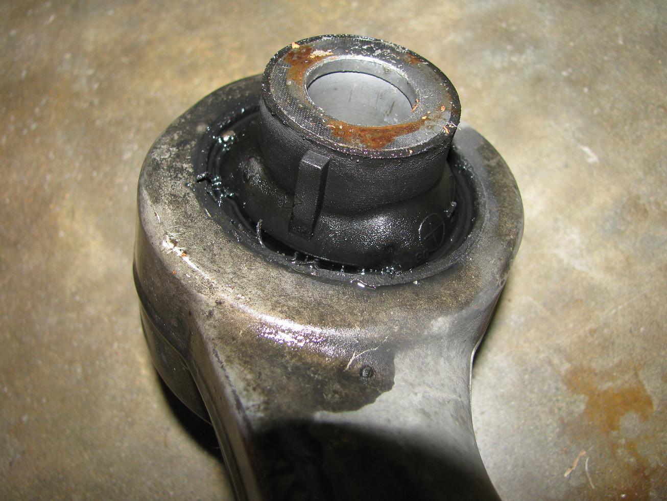

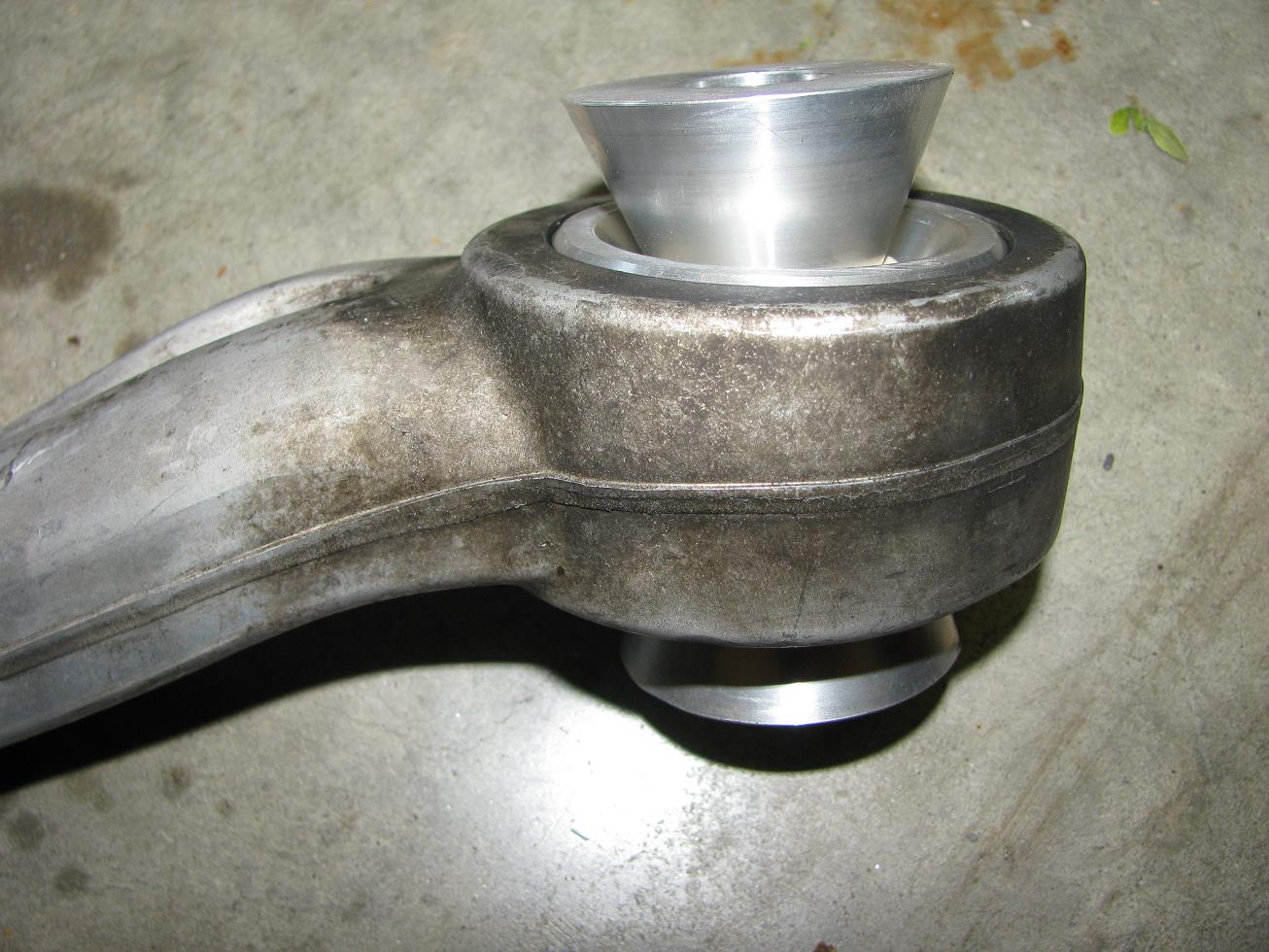

Pressed in

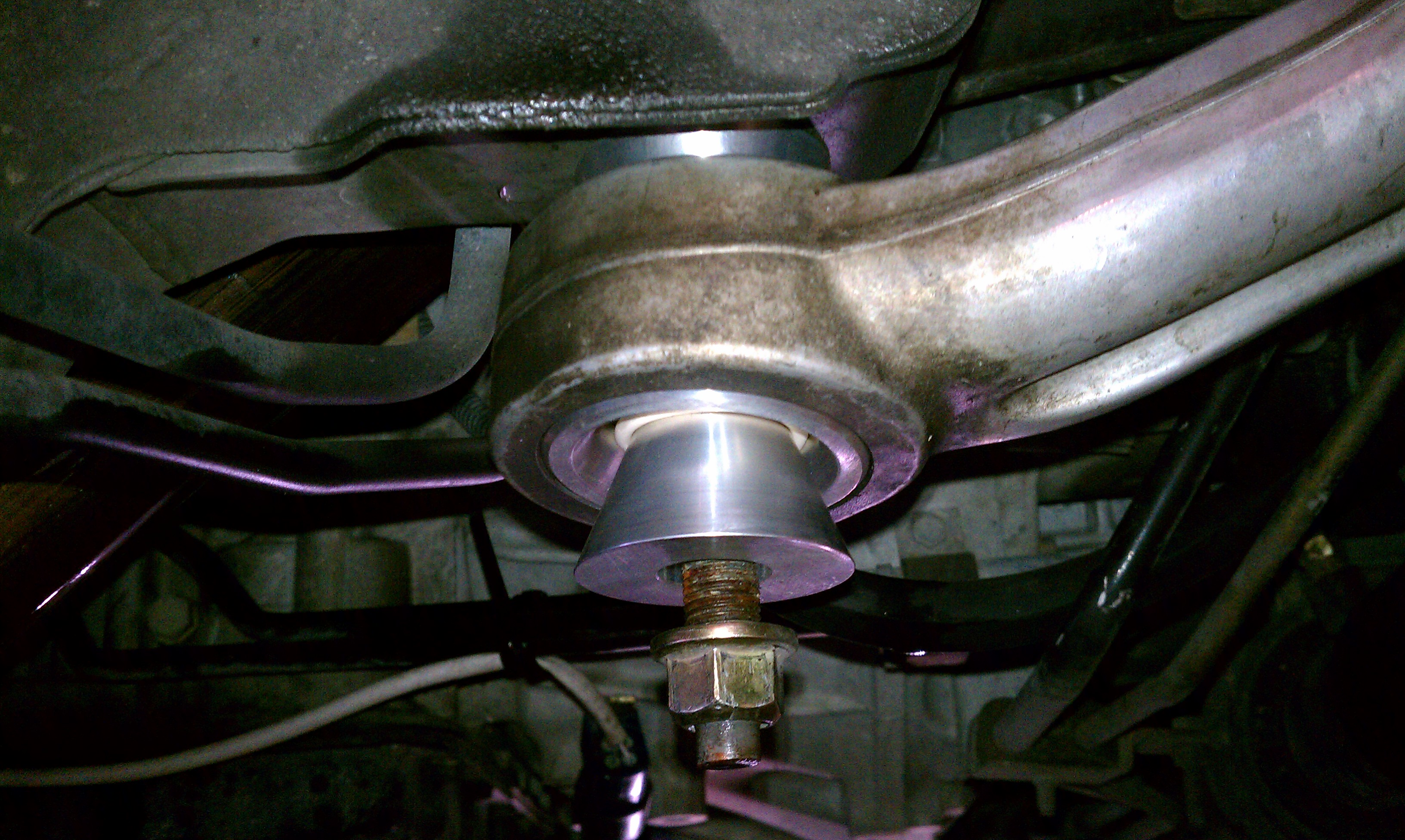

Back installed
personally after looking through all of the compression rods available...hands down I would install SPL over any bushing into this particular spot.....The energy bushing I dont believe has any pivot angle like SPL since its just the center metal piece around the bolt with the Urethane bushings just set up in there since everyone seems to claim that you dont press them in.
