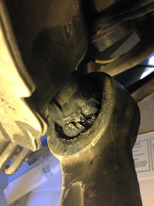

Well into the process of doing front lower rear compression rods. Driver side no prob. Passenger side, "not so much". Had to grind off the nut and ball joint shaft on one end. Now I'm facing a saws all approach to get the remaining part of the arm off. THE Rusted-on bushing... Prolly gonna have to be a combination effort with cutting foot holds into the metal bushing for the three arm puller. It HAS to work. At least without torquing the bolt on frame. VERY frustrating.
Update:
Heat was the eventual winner with a little help from some Chanel locks. After everything was cleaned up the exchange was pretty easy. Rides MUCH mo' bettah.

it seems that most have trouble doing this install and im not sure why...I pulled off mine the other day to install my SPL bushings and man everything was a breeze for me. been lowered on my g35 for 2 years now......tossed alittle bit of PB Blaster on it about 2-3 hours before I started...I undid the bottom nut first on the front suspension knuckle to free up any tension against the compression rod.
Then I took my crow bar in between the compression rod and the body and just pried down alittle and both just slid right off. I didnt use any form of a power tool either. I broke loose all the bolts first with my breaker bar just to get everything started and then hit it with my air rachet on low speed and everything came off like a breeze
Note that whenever they came off there was def rust on the bolt and I can see where some can have problems but mine went pretty dang smooth.
not sure how bad mine were but they were all def blown.
