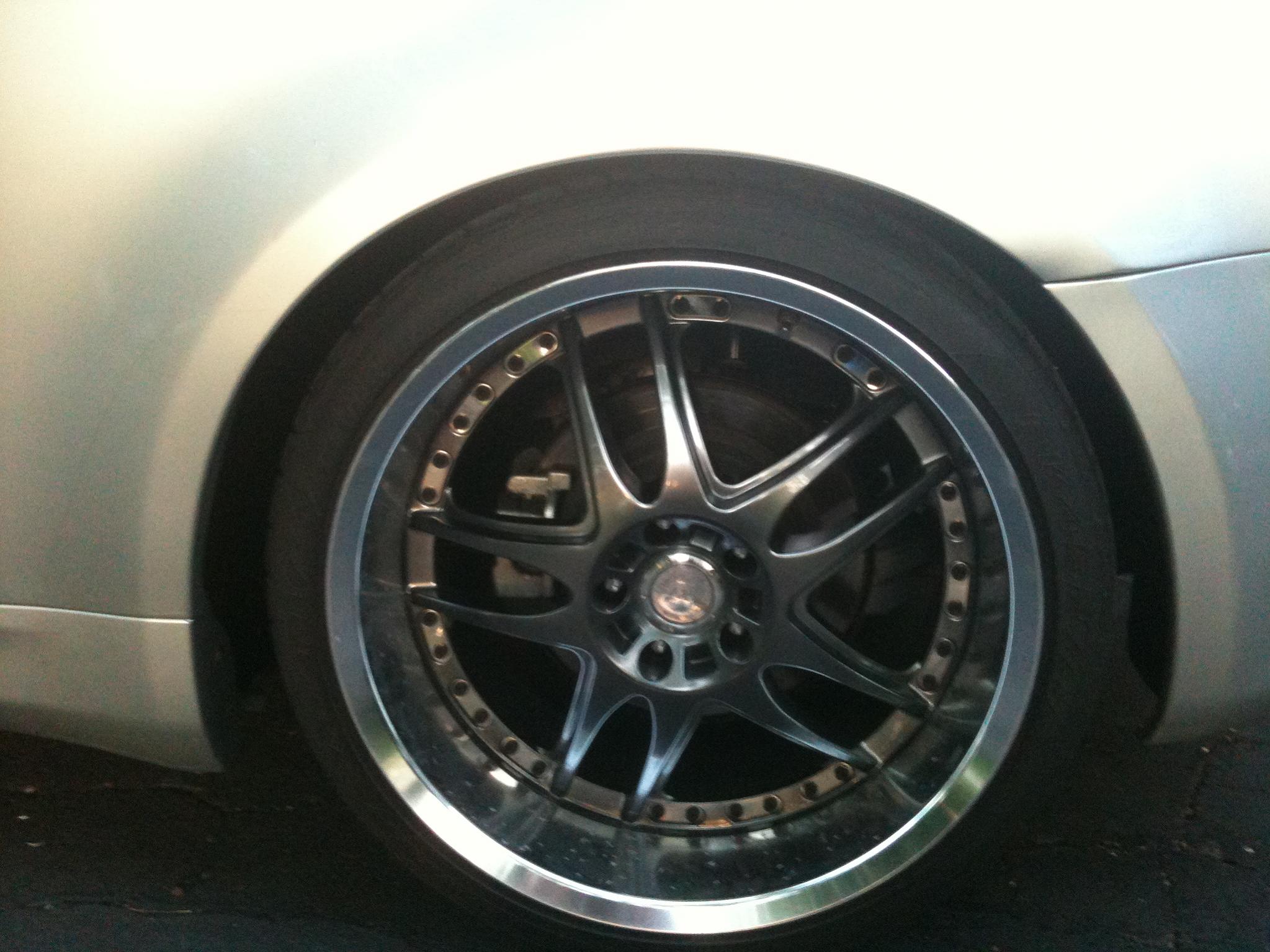

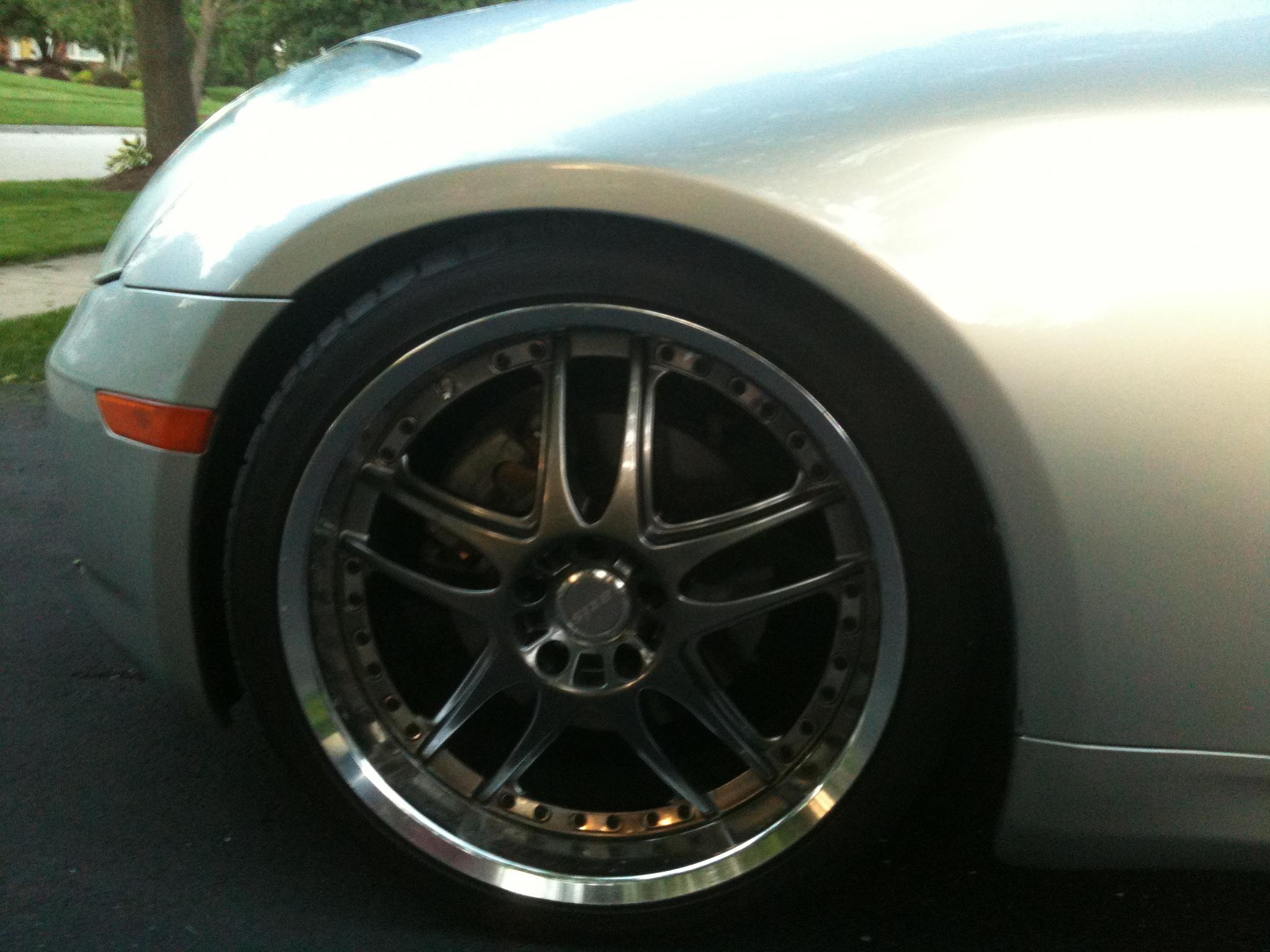

Some pics after da drop
Attached Thumbnails Problem after BC Racing and SPC kit install-img_0489.jpg   Problem after BC Racing and SPC kit install-img_0491.jpg   Problem after BC Racing and SPC kit install-img_0496.jpg   Problem after BC Racing and SPC kit install-img_0497.jpg   Problem after BC Racing and SPC kit install-img_0499.jpg
