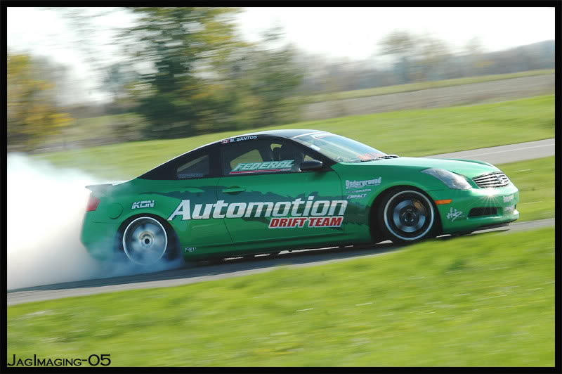

Many G35 dedicated drift and time attack cars use stock brakes without any issue. The Rare JDM G35 doesn't even have stock brembos.
