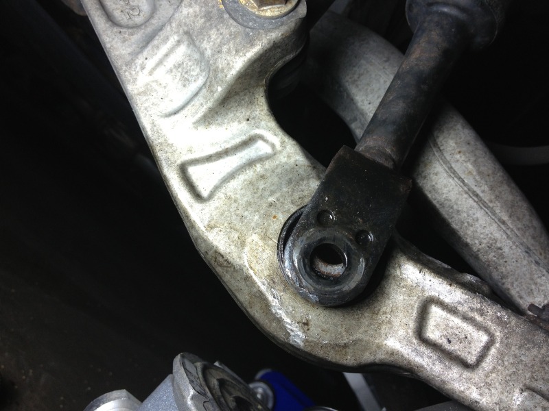

Note: I used those nut extractor sockets by craftsman. It still took alot of effort to get it off but eventually it got loose. I had to hammer the socket down onto the nut so it will fit snug in order to catch & loosen.

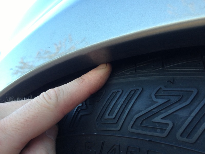

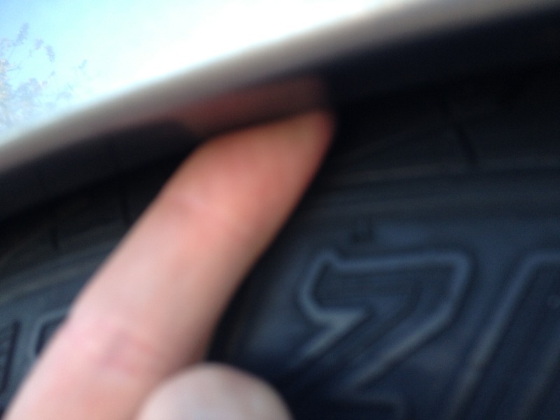

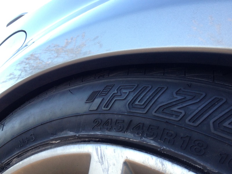

Welp got my suspension done..finally. Wish it was a tad lower in the front but the rear is sitting pretty. Its almost too low in the rear, i have like a nails amount of space between the rear tires and fender. Hoping they dont rub when it settles.
I could always remove rear spacers if needed. While I got new tires on the rear today I check out the exhaust on there shop rack and damn...its rusted out...at the muffler its completely eaten and right behind the flex pipes its really, really closed to be gone from rust as well.....ill either look to replace the entire thing from header back or have my guy fab up a custom replacement but use the oem muffler. I suppose ill shop around this week and listen to exhaust clips. I just dont want this thing sounding like a civic, the stock sound is exotic and beautiful so keeping that style tone is a must.
Heres what a stripped nut looks like...finally got it off like 2 hours later...

Ill clean her up tomorrow after work, replace the stripped bolt immediately & snap some better pics to reference. Ill also be looking into a camber kit to help save the tires but for now this will do.
