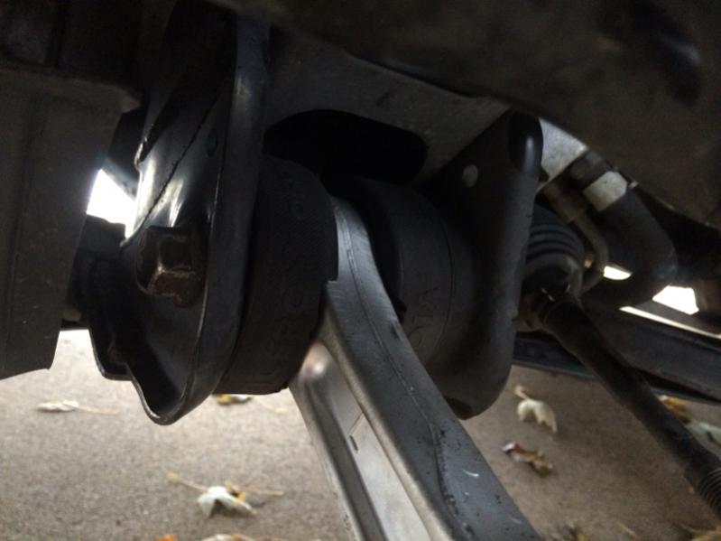

Hey guys...so I have had my 2003 g35 coupe for about a year and have had the infamous problem with compression rod bushings. I found so much useful information on this site! I just replaced both today with Armstrong poly bushings...and when i got them in and I went to tighten the lug nuts, there was an inch play in the whole knuckle assembly! And when Im stopped and tap the brakes a few times, I hear a terrible clunk and I can feel the play. Also have play at high speeds when I hit the brakes. The new bushings are great, but do I have a new issue arising now? Could it possibly be the front lower control arms now? It's my daily driver so I need to figure this crap out soon! Thanks guys!

I can tell you right now that you upper and lower control arm bushings are bad along with your ball joints. Mine is an 05' and has 127k on it and they were all shot.
Look at the control arm pivot points where the bushings are. I'll bet they are sitting against the hinges and not centered between them. That's how I figured out mine were bad.

As I see it, the upper control arm bushings are a bit off center like you were saying, Texasscout. The upper ball joints look a little smashed too...but maybe thats just how they look.
The lower control arms on both sides of the car move towards the cab of the vehicle when I put force on my tire iron. That is where the most play is. The bushing that connects to the chassis looks like it needs replacing based on that play...visually its okay though. Ordering some new lower control arms on rockauto.com tonight!
The new compression rods have fixed quite a bit...there is a noticeable difference in steering and cornering...much stiffer. Also doesn't clunk over bumps. It is like my car likes the up and down motion of the suspension, but not the forward and back motion. Texas, I think you are on the right track with replacement of: most importantly, lower control arms. And then upper control arms shortly after, when I can afford them
