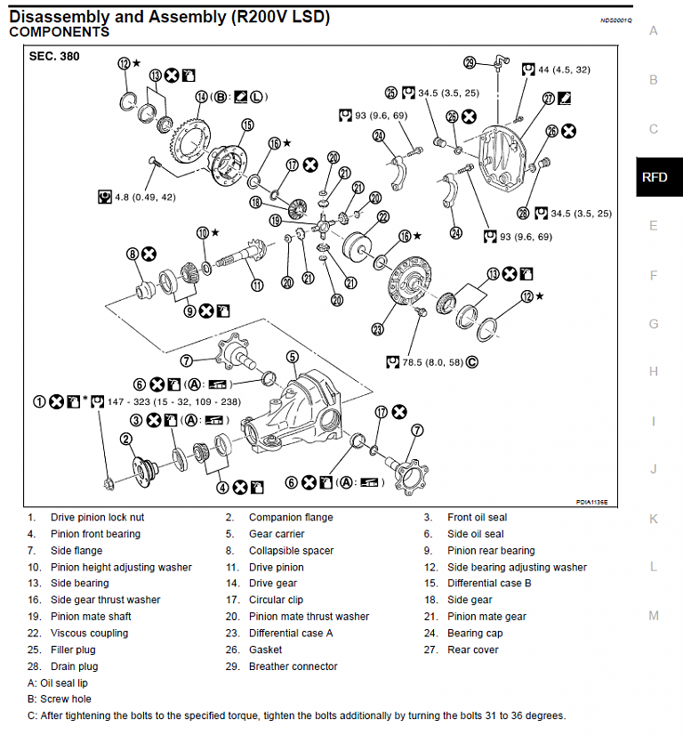

Number 10 on the pic from passenger side is sliding in and out of a diff about quarter of an inch.
My car was previously Tboned on that side and impact went into the wheel. So there are possibilities something was damaged there during the impact. It served me fine though for few years with no issues and only recently started sliding.
Does anyone have any knowledge of what could be possibly damaged there to cause the sliding?
Also if I do replace entire diff. I remember folks upgrading to a different ratio from newer model Gs. What do I need to be looking for If i was to upgrade.

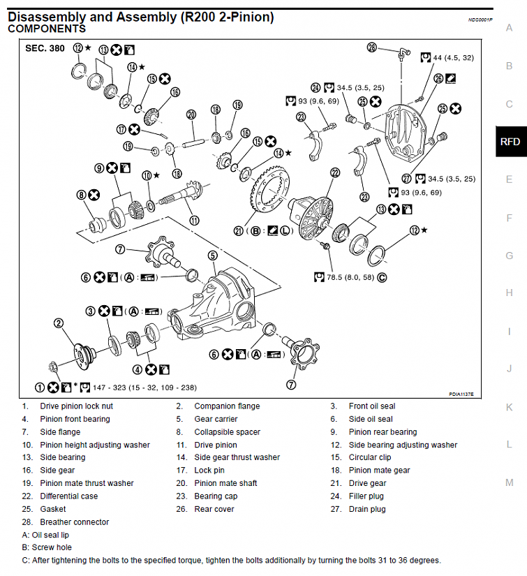

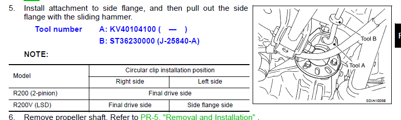

There is a circular clip that holds the axle flanges inside the diff. Possible it was damaged during collision.
If you have an open diff, they're located in the final drive for both sides.
If you have LSD, then the clip is in the final drive on the right side, but on the output shaft on the left side.
The flanges press into #14 in your picture.
Attached is a snip from the FSM. If the circlip broke, then I hope the magnet in the drain plug caught it before it bounced around inside your diff.
Open Diff, #15 are the circular clips (there's 2, both are in case)
LSD, #17 are the clips (one is in case, other is on the output shaft)
Hope this helps solve your problem.

I thought there is a clip holding the flange, but all videos I saw even the service manual (2003-2004 though)
including the picture you posted do not say anything about removing no clip. They simply say to attach the bracket for the flange and use a sliding hammer to pull it out. Nothing on removing cover and taking off the clip.
In other posts and videos I ran into same info.
Weird.

You don't usually have to remove that clip, it more or less locks the half shafts in place. That's why you have to hammer them on, if that makes sense.
As far as the diff you're looking at, the best way to tell is to remove the back cover and look. Spinning works too and that does sound like an open diff.
