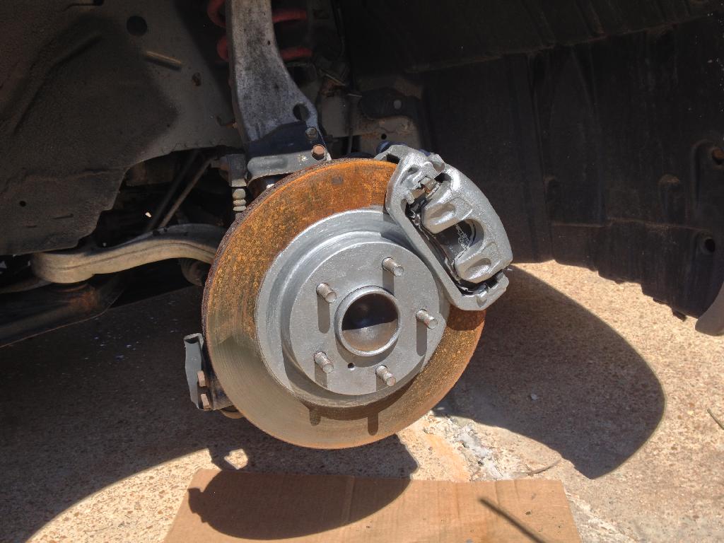

While my car is down waiting on some headlights I went ahead and did my calipers in silver. I still have my winter wheels on but the summer setup will be on in the next week or two & the calipers are much more visible behind my summer 20"s. Ive used this caliper kit before about 6 years ago on my weekend car and they still look like they were freshly done so I know this will last. Its a brush on kit so you only have to remove the wheels, after 8+ hours the paint hardens & stays smooth.
Time Required: About 1.5 hours with me relaxing a bit in between. I did the fronts first then the rears. 2 coats per is all that's needed. Just thought id share, i love this brush on kit 100x better than painting them, it last for ever, dosnt flake or chip and is easy to apply. They can also do custom color sets per request but i usually stick with basic silver or black.
I went back and cleaned up the black boots when I was done, had a little overbrush on some of them but wiped off easy.

Old Apr 6, 2014 | 10:58 PM
digital sol's Avatar
Joined: Jan 2010
Posts: 478
Likes: 28
So I finally got around to painting the rusted center hub and such today. Honestly this took like x3 longer than I expected. Spraying would have been 10x easier but perhaps this will last longer as it did on my calipers thats for sure. Anwho I bought another brush on kit, same used for the caliper and went to town. Dont worry about the bad tape job, the first time I hit the brakes anything in the contact path of the pad should burn right off. It took 2-3 coats per rotor which is why it took so long. Its quite a bit of surface area for a "brush" application. The surface rust on the entire rotor comes off the first time I hit the brakes, its rained here like 5--6 times in 2 weeks and the car has been sitting that entire time.
Ill get better pics later in the week but here's some basics on the stock wheels.

Rattle can high heat exhaust paint does the job too!
I used rattle cans of high heat paint close to the Twilight Blue paint on SLICK five years ago and it still looks new and shiny. After removing the wheels and spending time cleaning the rotors/calipers with carb cleaner, then masking off those area I didn't want to paint the results were great...Gary
If i ever have to do this again I will definitely use spray as the brush on just took soooooooo long. It matches the calipers perfect but took for ever to finish. It will look 10x better after I install my summer rims & take pics after driving the car so the surface rust is gone. Car sat for like 2 weeks while I worked on it/waited on headlights & it damn near rained like every day. I also have front and rear spacers that cover the entire center hub but only the fronts got reinstalled because the rears don't fit with my summer wheels until I get the rear fenders rolled & i figured I might as well seal/coat the entire thing while I am at it.
