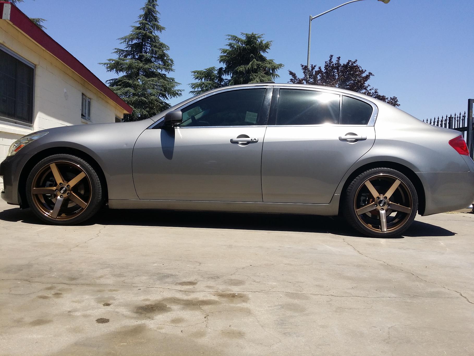

Ok I have a 2007 infinite g35 sedan base model rwd. I just got some 19" rims 35 series tires. Now my car looks like a lifted truck lol. I'm on a money crunch right now and hoping to go the cheapest route Wether it be stock or aftermarket. I've found lots of 03-07 coupes all models seem to be interchangeable EXCEPT for 07 sedan rwd (at least that's what all the threads and stores say) is this true? And if so, what's the difference?

P.s. I'm just looking to lower a bit for now. Not trying to tuck. I'm more of a 1/2" between tire and fender type of guy and right now I'm about 2"-2.5" of wheel gap

Thanks I might just give it a shot. Hopefully I don't run into any fitment issues... I'm new and don't know how to post pics.. otherwise you could see how bad it is lol

My 07 sedan
Attached Thumbnails what is the difference between 03-07 coupe suspension and 07 sedan?-20140813_120735.jpg
