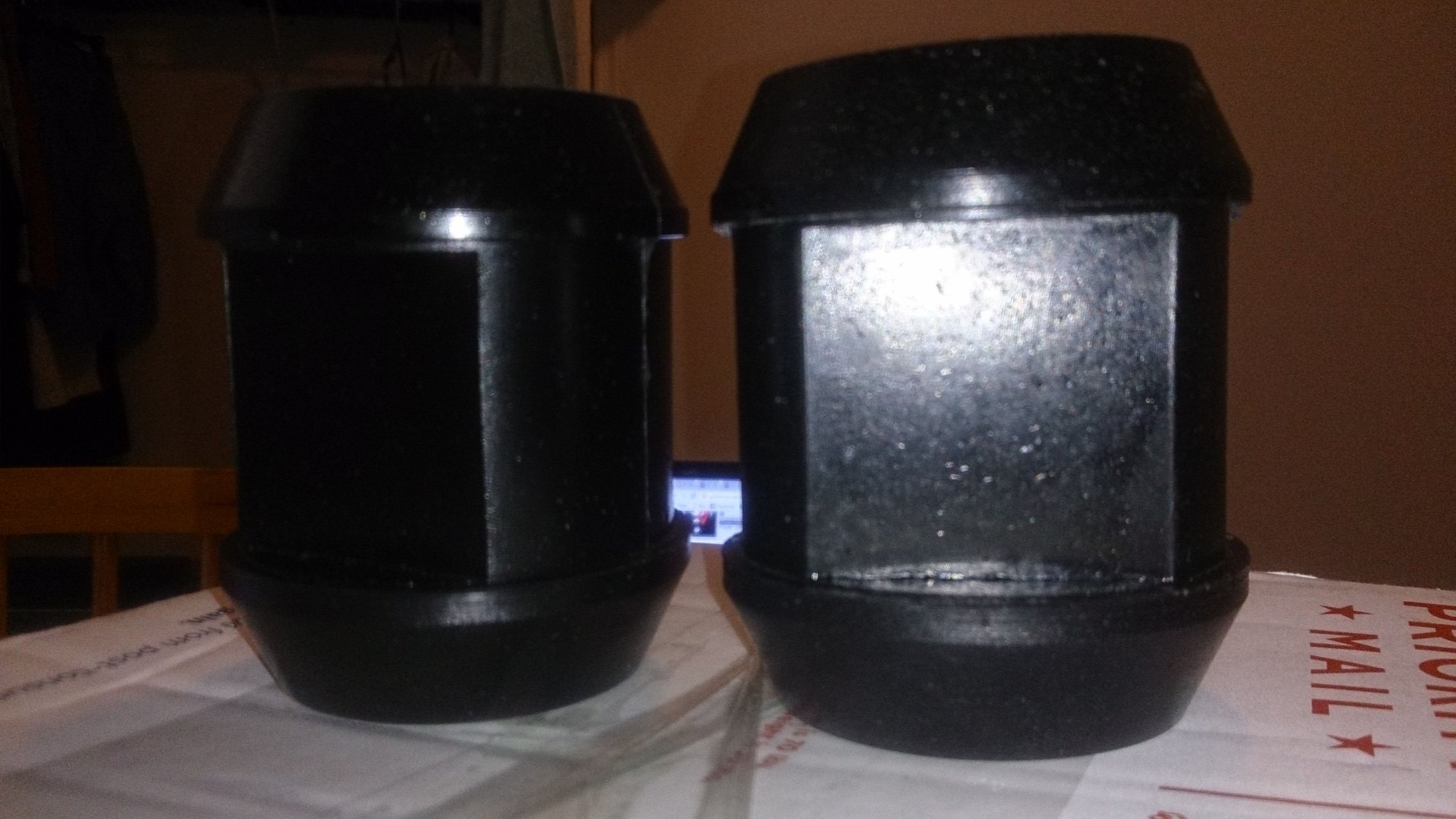

Got a quick question on the compression arm bushings.
This is the arm in question
Does anyone know if there is a specific way to install bushings.
Here is what I mean.
These are armstrong bushings.
As you can see they are round with a flat cut outs (across each other)
This is a stock bushing
There is also some sort of an indicator on the bushing and it is hollow in two places across each other as well.
So the question is. Is there a right and a wrong way to install these bushings? Should the hollow side be facing into any particular direction?

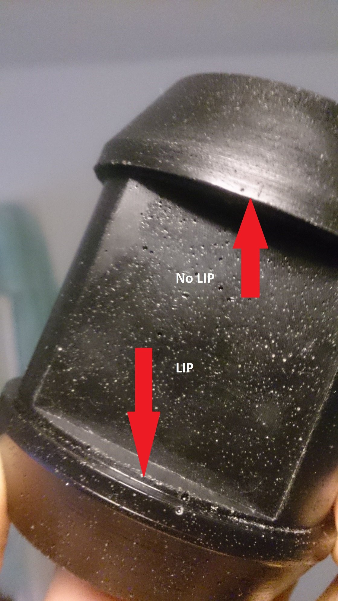

2. Is that lip/edge an issue (it's not on the other end) - Look right where the flash is concentrated and then look at the bottom of the bush.

2. Still need to question this

This is the lip in question

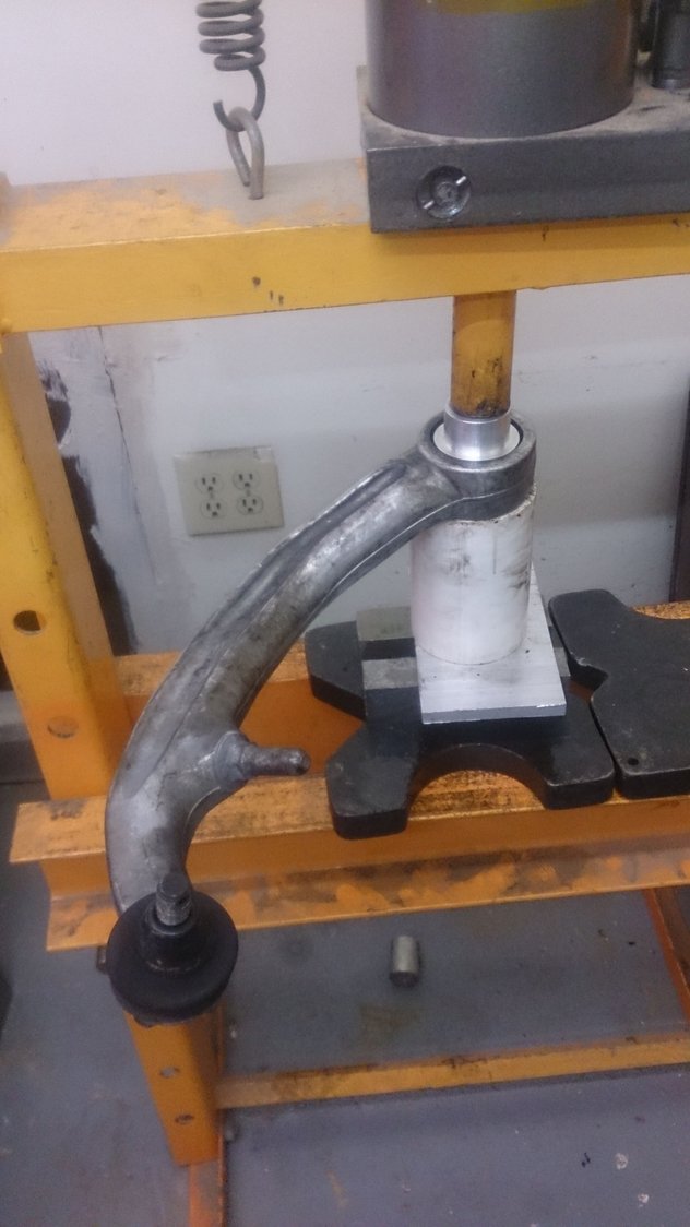

I sorted this out last week, was very simple.
Luckily found a nice sized piece of aluminium and an appropriately sized bit of pvc tubing.
The lithium grease supplied with the bushings was more than enough.

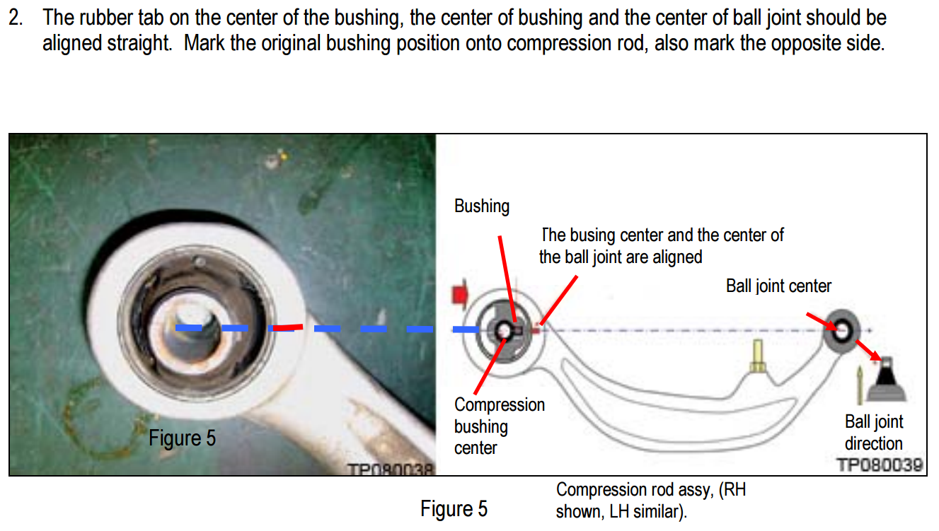

For future reference, the flat part should be oriented to that it faces the ball joint. I guess that's technically the front of the car, but it's a more specific focal point for orientation. If you draw a line between the ball joint and the bushing, the line should hit the center of the flat spot. The flat spot is there to allow the arm to articulate up and down. On the stock bushings, there's a little tab, that should point directly at the ball joint. Source: the TSB (ITB08-013a) for replacing the compression rod bushing has a handy picture.

6 bolts and 2 nuts and the A-frame is off.
2 nuts for each ball joint + some mallet action and the arms are off.
Press bush out, lube new one, press bush in.
Putting the arm back in can be tricky because of the whole susp leg is pressed down with the spring in place. I loose fitted the ball joint, used a jack to compress the suspension a little at a time whilst tapping the comp rod bush up along the stud till it's seated.
Then bolts/nuts back in, torque and cotter pin where needed.
That image works for the OEM bushing. Without any research I would have followed something like that for the Armstrong bushings just by observing how the bush should be allowed to pivot and where it should stay constrained. But after calling Armstrong/PSB I got the instructions as mentioned above.
