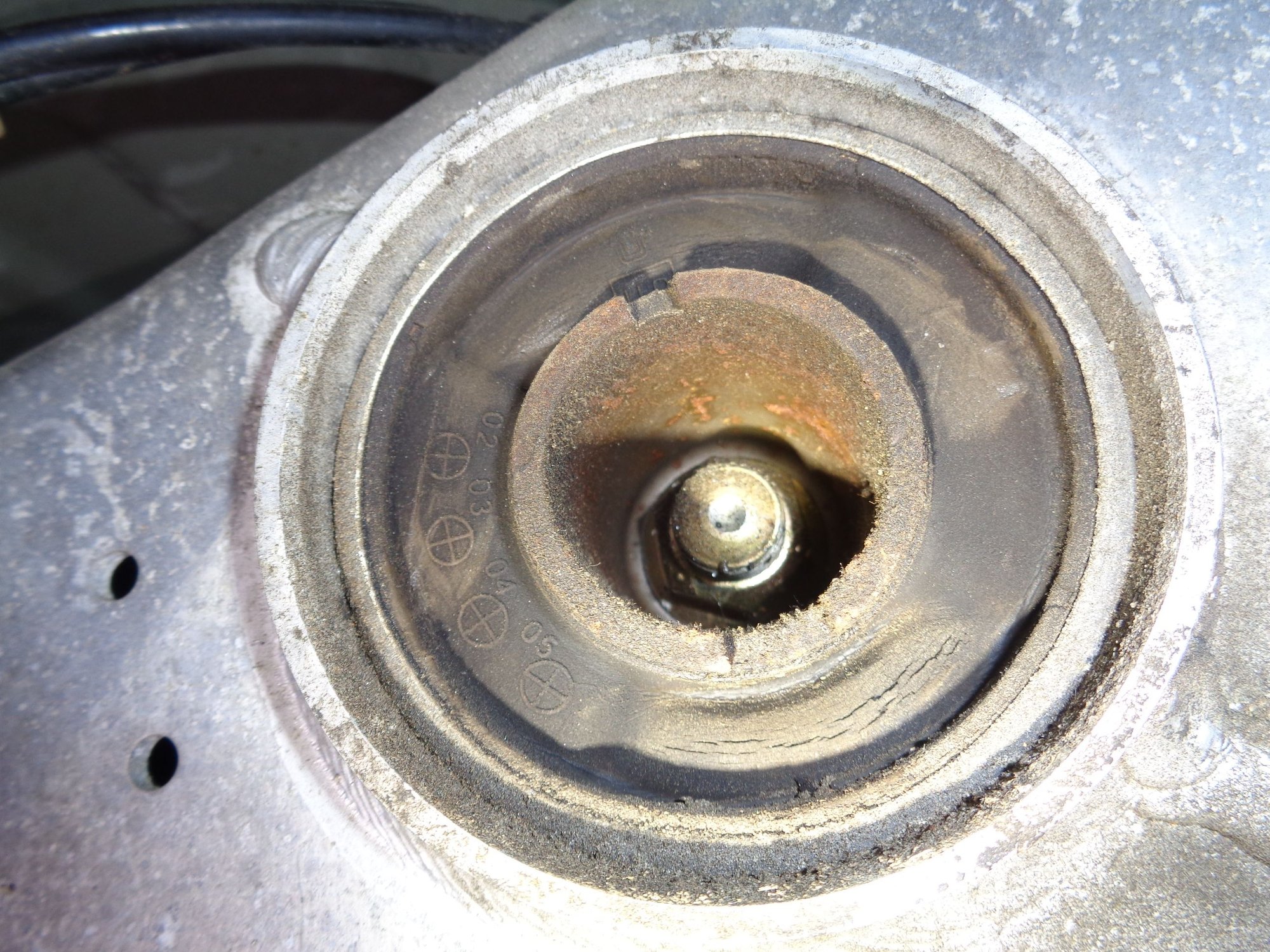

It looks and feels like the sides of the bushing are solid. I press on the top and bottom and it easily gives but the sides do not. I'm not sure if this is the same for the G? I do think that this bushing has far less importance to an all wheel drive car but still needed.
Top and bottom of bushing is indented and wrinkled indicating wear. Sides are solid. I think this bushing is only 1/2 filled with siicone.
Bushing popped on the diff side.
It's fluid filled in the top and bottom portion, but not on the sides. The sides have a solid rubber portion of sorts.

Yeah, looks and feels that way.

That looks great as far as a blown bushing goes. My car had been beaten with it for god knows how long with the previous owner and the top and bottom had lost their fluid long long ago., and the sides were starting to crack from all the flexing. You should have an easy time masking since most of that's OEM intact. Once the poly's in place, it'll reinforce what's left of your bushing.
How do you plan to clean and fill the cavities completely without any spillage?
