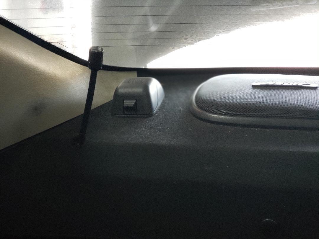

Finally Installed a Bunch of Goodies
05 G35 Coupe
BC Racing Coilovers with rear extenders - aprox 1" drop
z1Motorsports adjustable front upper control arms
new front lower control arms, compression arms and ball joints
z1Motorsports rear adjustable toe, traction and camber arms with eccentric lockout kits
Hotchkis front & rear sway bars with whiteline end links
Soul Function front strut tower brace and rear tie bar
Power Stop Z26 Extreme drilled & slotted rotors front & rear
Power stop braided stainless steel brake lines front & rear
Racing brake fluid
BC Racing Coilovers
front coilover adjuster
rear extenders - can't see them when the rear seat is in normal position
adjustable FUCA's
driver side rear from the rear
passanger side rear from the rear
Hotchkis Swaybars
whoteline end links
rear tie bar
Stop Tech drilled & slotted rotors
