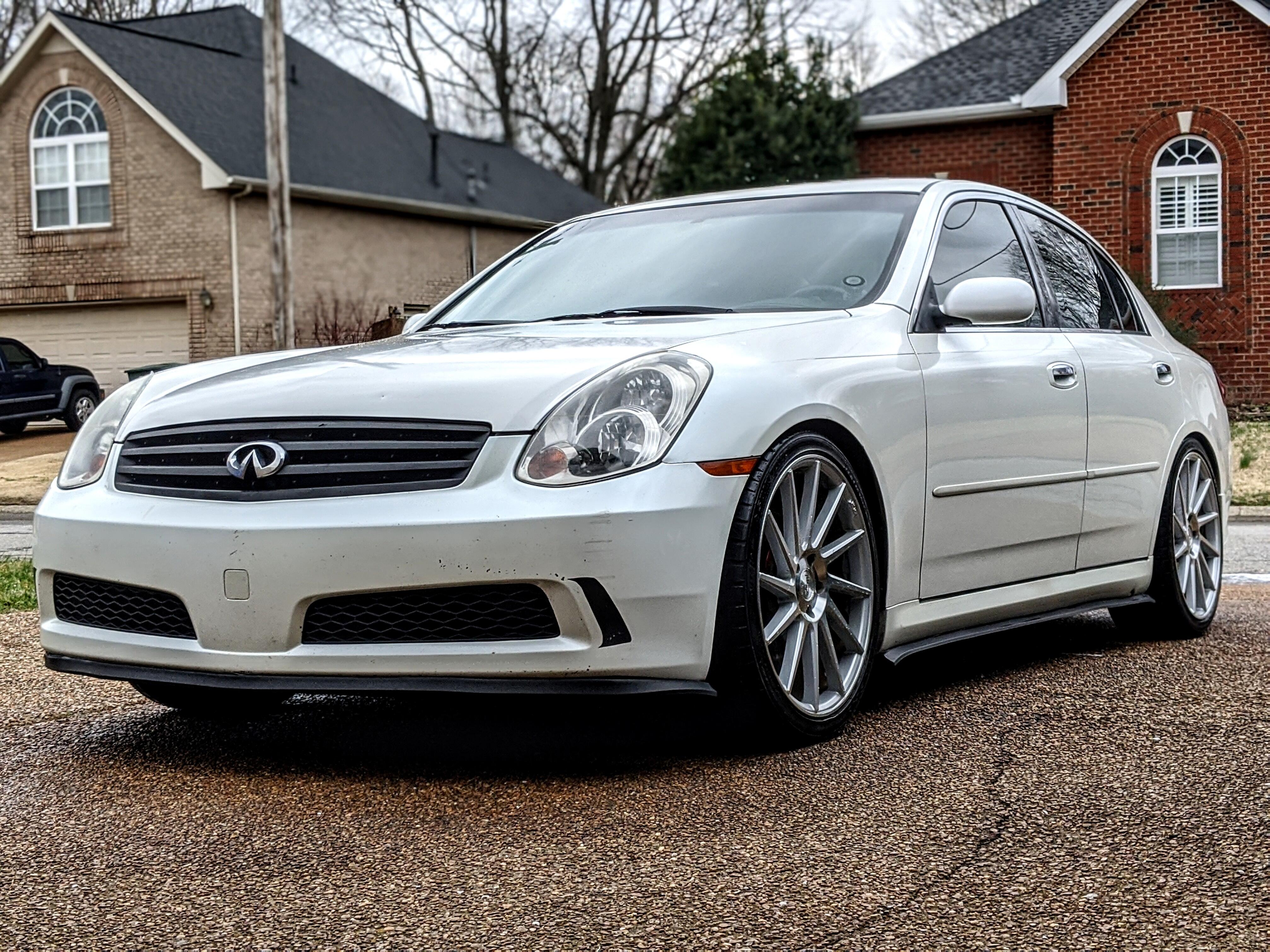

Hey guys,
I have a 2006 G35 sedan. I've had 2005 350z suspension (springs, struts, and shocks) on it for 3 years then I replaced the front struts with kyb G35 sedan struts. I've had them for about a year and a half now and now their bad. Clunking over any slight road imperfection.
Why are kyb struts going bad so quick? Any recommendations on better struts? OEM? Something that won't break the bank.

My experience with KYB are their cheap and always you get what you pay for. You went 2 years and depending on your driving style, roads etc id say not the worst.

The reason for the premature wear is your vehicle is lowered and using struts with OEM travel will just wear out quickly.
Bilstein makes the B8 series struts that are for lowered vehicles.
Is it just your fronts that are failing or the front and rears?
