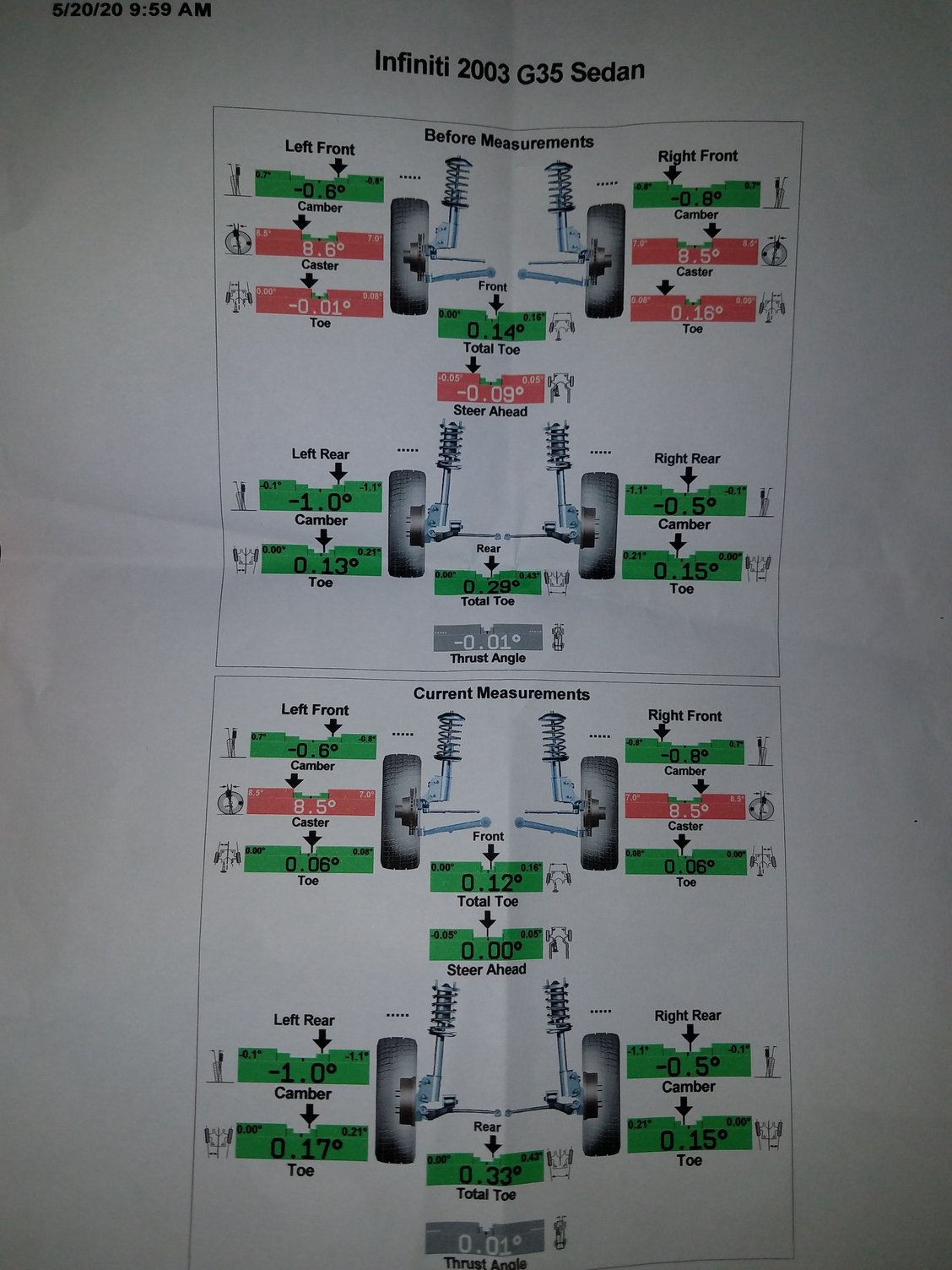

Here I'm attaching my specs. It veers off to the right about 1:00 or 1:30 on a clock. I tried looking in the FSM for the specs but it only has total toe in inches and not in a way I can make sense of. Also what's the kingpin?

8.5 degrees of camber up front? cripes

Camber says it's within spec? I think you're commenting on the caster? Would caster cause pull to the right like that? Even if they're both relatively the same (8.6, 8.5 respectively?) Also what would cause such a dramatic reading like that anyway?

rofl oops i read the diagram incorrectly my mistake

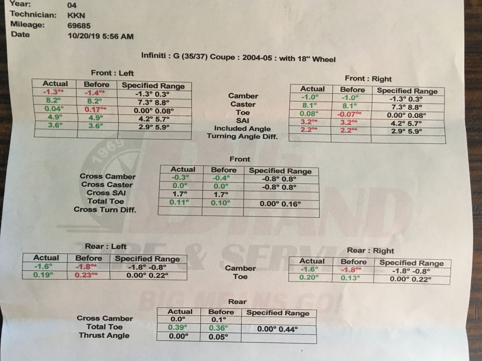

You're way outside spec on rear toe. You need to print the last page of the FSM sections FSU and RSU and give it to them, set everything at the nominal value except for front toe set it as the maximum value.

Also, in the before section of that alignment report you linked your specs for wildly off and I'm not surprised it was dragging the car to the right.

Yesterday I took it in to a trusted shop, not Evan's, but my main mechanic. He said that the caster/camber is way out of whack and not adjustable. I need to buy a caster/camber kit.
