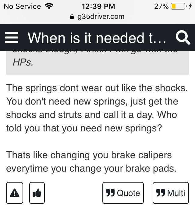

Spring/strut
Thanks for information.
A mechanic kept saying I need two springs.
I thought the same thing you said they “springs in rear, don’t go bad.”
Must be the factory shocks aka struts mainly.
So I can save a lot of money by getting new shock/strut replaced and not the separate springs...
To be more specific.
The car rubs, rocks and sags in the back, and a mechanic keeps saying get new springs, which are not sold, or cost $1400, for two rear springs from Infiniti.
Must be the top part, not the springs. What do you think. Thanks

Old Feb 16, 2021 | 02:20 PM

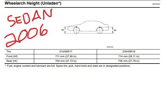

Take a tape measure, measure from the ground to the bottom of the wheel arch, measure directly across the centerline of the wheel. This is called your "wheel arch height". Make sure you are on a level paved surface, make sure your tires are properly inflated. If your wheel arch height is correct then you definitely don't need to replace the springs.
Here is a snippet from the factory service manual for coupe/sedan 2006. There wasn't much change across the years but if you post your exact year/chassis I'll post that snippet as well.

Sounds like a combination of things actually. Primary issue is most likely blown shocks, if you're anywhere near 100K miles, they're done for. You can get KYB or Tokico front struts & rear shocks for reasonably priced. rockauto.com is a good place to start. https://www.rockauto.com/en/catalog/...+absorber,7556
Now, some of the "sagging" can be worn out suspension parts as well. All bushings should be inspected - PROPERLY - and replace any control arms that have blown bushings. If you have a lot of sagging, the spring upper seat might be toast. Those things have a direct impact on ride height, shaving them down used to be an easy way to lower the car 1/2". https://www.z1motorsports.com/rear-s...t-p-13650.html
Do yourself a favor and get off ebay. Those coil over setups will fully replace the stock springs and shocks/struts, however the quality of those cheap parts is trash.

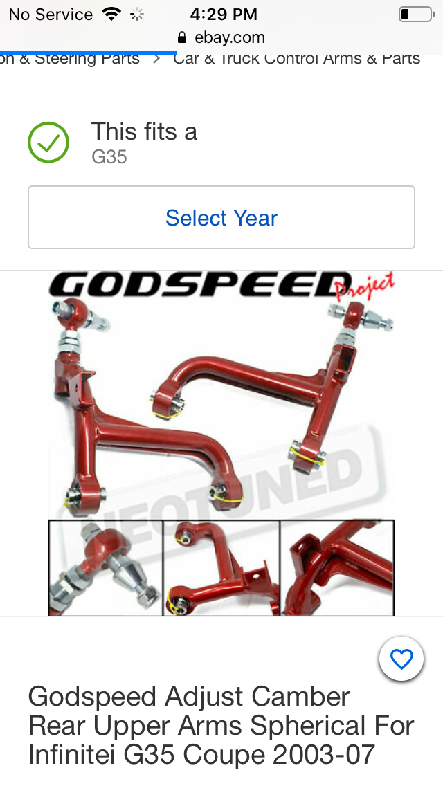

will this eliminate the drilling and the eccentric screw kit, for the rear? Just wondering to adjust negative camber for the top of the tire pulling in everything else is good.. Not sure if it’s worth it, without real good name brand coilovers and a full makeover... it’s just a bad offset wheel, and the top tires in the back are about 1 1/2 in from the top, since I changed the offset, I had to.
think it will work instead of drilling the frame and buying two pieces to just get the offset and top pulled in, instead of using the toe adjust and lower arm?

If you are on the stock springs and not lowering the vehicle you will NOT need to widen up the eccentric bolt holes, you can just reuse the existing eccentric bolts.
The higher range eccentric bolts are only needed if you are lowering the car.
You definitely want to stay away from adjustable arms like the ones you just listed that have solid heim joints instead of polyurethane bushings. They are VERY aggressive and usually loud/clunky.
