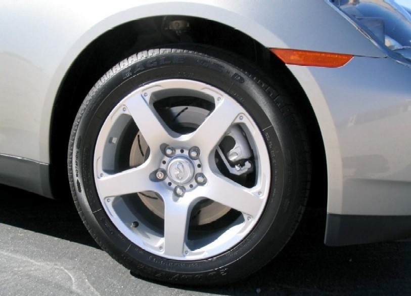

And it (RacingBrake's Big Brake Kit) works very well. One of the very best mods I've come across.
Great price, great looks, improved braking (both cold and hot) and no change in brake bias.
Attached Thumbnails Can Sedan run bigger rotors with stock calipers?-racingbrake-front-rotors.jpg

Big Brake kit is EXPENSIVE though! I just want bigger rotors if I can get em.

Here you go....Racing Brake
The kit uses a bracket to relocate the caliper.
I'm running RB rotors & they are a great product.. TOP quallity
ALL non-Brembo cars are the same (pre '05)

1. Define perform better. Better one time stopping distances? Probably not much if any difference, assuming all else is equal. Better at resisting fade from repreated stops? Yes, just for the shear fact that the rotors are way bigger at 13" and can absorb more heat. What's interesting is that the rotor they use is actually lighter than the OEM non-brembo rotor even though it is much bigger.
2. Perform where? On the street doubt you'll see much of a difference between the two. On the track, depending on how hard you are working your brakes and skill level, I would say that the Stoptechs are better due to the 4 piston, lightweight caliper design that allows better brake modulation.
Good thing about the Racing Brake kit is that you can get the BBK look you want at all four corners for relatively cheap and still have something that will perform better at the track over OEM. Also pads are cheaper to replace than say Stoptech ST-40 caliper specific pads.
But for someone like myself who is more into performance than looks I would rather spend that same $1,700 on a front only full BBK kit, since the majority of the work is at the front wheels anyways.
Having said that the Racing Brake kit looks like a really good in between solution. The one thing I would want to know is how much, if any, of the brake bias was aletered with their kit.
