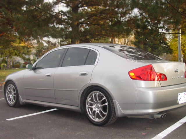

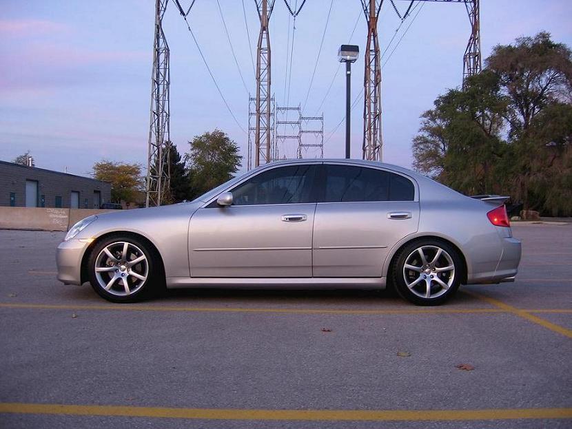

You'll definitely want to use rear coil spacers as suggested by socal-oc. I have the exact same spacers he used - they require a little trimming though - and here's how my drop looks with 350z H-Techs...........
Attached Thumbnails 05 Sedan w/ 350 Tein H - How much to correct camber issues?-pd-rear-left.jpg   05 Sedan w/ 350 Tein H - How much to correct camber issues?-pd-left-side.jpg

Teeter is the man. He is the one who helped me with my suspension setup.
Looks great and thanks Teeter for the recommendation, really happy camper here
