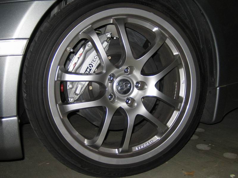

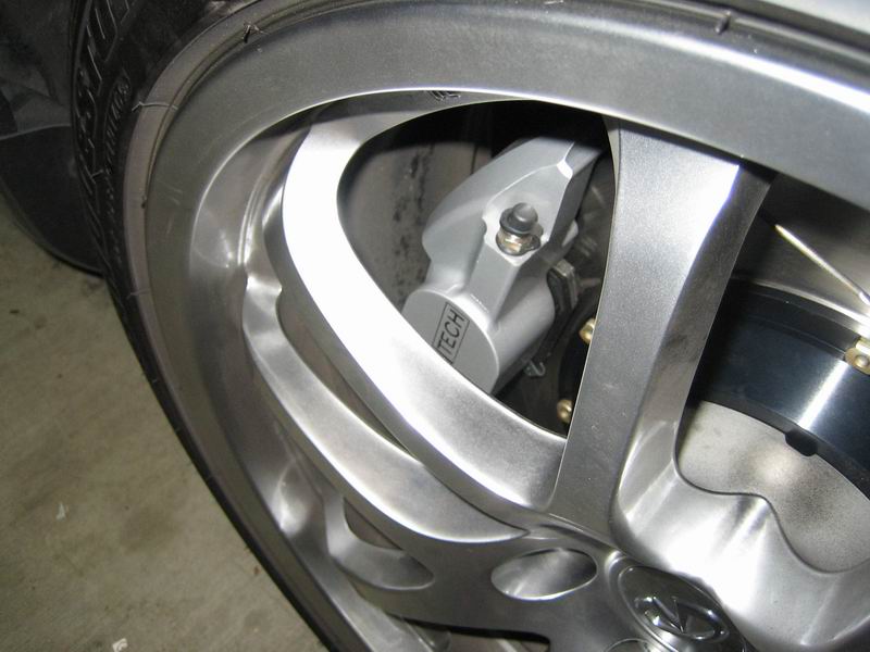

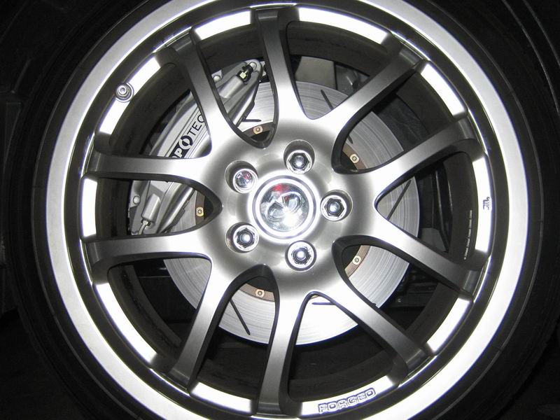

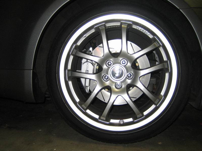

Just to let everyone know, StopTech finished their checkout of my 2005 Coupe with a 4 wheel 13" kit on it. I guess I was the first person to put their kit on a 2005, since they hadn't tried it up until now. However, Matt Weiss there tested out the kit and gave it the stamp of approval. I'm taking it to the track this weekend so we'll see how good it really is. For pads, I'm running Pagid Orange on the front calipers and Axxis Ultimates on the rear. I also switched out my fluid to Motul RBF 600, so things should work really well.
I posted in another thread that the StopTech kit didn't fit, but it turned out that StopTech just gave me the wrong caliper bracket adaptor for the rear. Since they didn't ever try their kit on a 2005 before, they thought that the brake changes were the problem. However I let them keep the car for a couple days and they swapped out the bracket and even checked the piston sizing to ensure proper brake balance. Matt and the guys there seemed very thourough and were nice enough to give me a little tour of their facility in Torrance. I also found out that not only do they sell their branded kit, but they also make the brakes for Saleen and Toyota Racing Development (TRD).

How come the rear calipers look so much like the stock Brembos from the '03-04 cars? Is that the only option for rear calipers for the 13" kit? I figured both front and rear calipers would like almost identical and the rear would be slightly smaller but the shape would be the same.
Old Dec 16, 2005 | 12:22 PM
StopTech's Avatar
Posts: 136
The two calipers are actually very different when placed next to each other although both two pistons.
Brembo rear 2 piston, 322x22mm non-directional rotor
http://img308.imageshack.us/img308/7...forwrx30bj.jpg
StopTech rear 2 piston, 328x28 w/ 2 piece AeroRotor. If you put the StopTech 2 piston caliper next to the Brembo 2 piston, our ST-22 is much larger and stiffer.
https://g35driver.com/forums/attachm...9&d=1134718570
StopTech rear 4 piston 355x32 w/ 2 piece AeroRotor, here is the other option for the G35 rear. (WARNING - very large picture)
http://img308.imageshack.us/img308/8570/dscn18273ib.jpg
Old Dec 16, 2005 | 01:50 PM
hayaku's Avatar
Joined: Jul 2004
Posts: 318
From: Los Angeles, CA
Howard, what's up, I see you're on these forums too. Anyway, Espresso, from what I've learned in the past and from Matt Weiss at StopTech told me, the majority of your braking is done by your front wheels. Under heavy braking, the weight of the car shifts forward giving the front wheels the most grip. Thus, your rears don't need nearly the stopping power. StopTech balances their kit to ensure an even braking force front and back. For the 13" kit they determined that the 2 piston caliper was suffient using the stock master cylinder and stock brake biasing.
