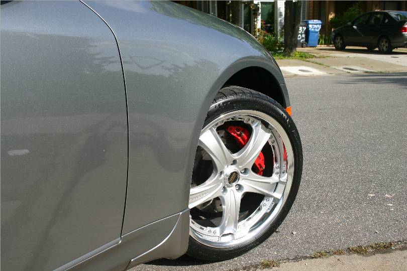

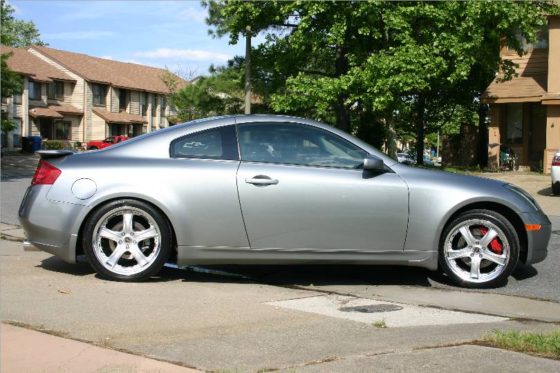

AP brakes dont work with Volk +24 offset
Finally got my new Volk GT-AV 19x8.5 front and 19x9.5 rear with 275/35/ZR19 rear 245/35/ZR19 front Michelin Sport Pilots. Well to make a long story short Stillen said the rear wheels would fit. Well guess again. Rear calipers hit the spokes. Stillen wants me to purchase new extended hub bolts to put a 15mm spacer on. I had to put the original rear brakes on. I dont trust putting on spacers. I am just going to buy a new set of Stoptech brakes which I know will fit and sell my AP brakes.
Attached Thumbnails Stillen/Volk GT-C tire and wheel package?-wheel.jpg   Stillen/Volk GT-C tire and wheel package?-wheel1.jpg   Stillen/Volk GT-C tire and wheel package?-wheel2.jpg   Stillen/Volk GT-C tire and wheel package?-wheel3.jpg   Stillen/Volk GT-C tire and wheel package?-wheel4.jpg

Old May 16, 2006 | 06:56 PM
Andy2434's Avatar
Joined: Apr 2005
Posts: 11,717
From: S.F. Bay Area
Your new wheels look great. Enjoy!
