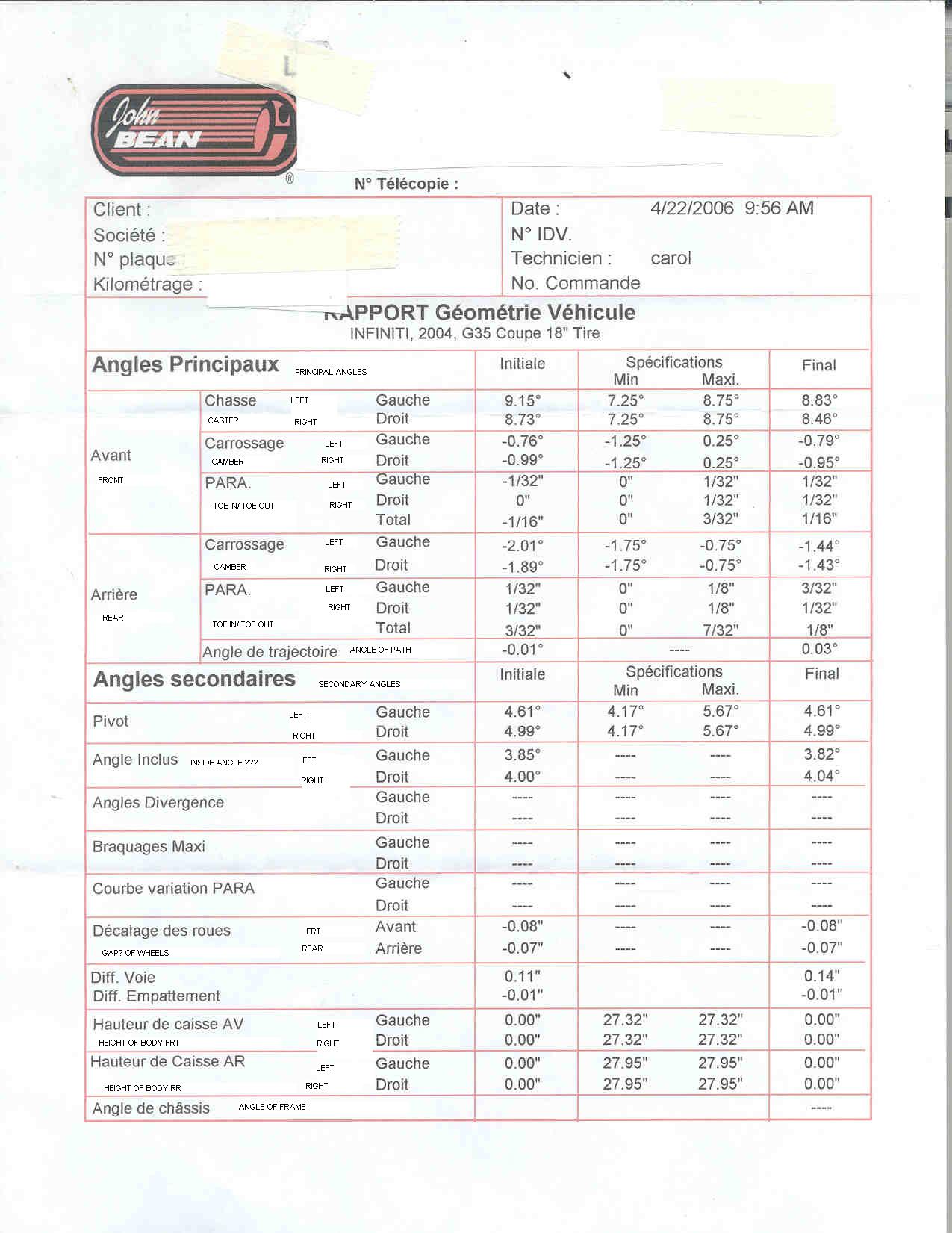

Hi there,
This weekend I got my alignment done on my car, I had no problem before (except inside edge of stock pilot worn out)it's just that I bought new tires andf I want to get the max thread life from them that I can.
This is the report from the machine, what do you think? did he made a good job?
should I be concern because one the spec. for the front left wheel is out a bit...
What's your opinion?
BTW..I live in quebec Canada... english is not the main language around here.. that's why the report is in french...If you want I can help to translate if it's not clear enough for you.
Attached Thumbnails suspension specialist, come check my alignment spec. sheet please.-testev.jpg

yeh i think you will get more help if you translate it

Ok, here's the translation version of it to the best of my knowlege
Please, check it out and give me your opinions (if you know what you are talking about...)
Attached Thumbnails suspension specialist, come check my alignment spec. sheet please.-copie-de-testev_rapportanlignement_traduit.jpg

it looks good to me
the only thing i see that needs to be fixed is rear toe that should be the same for both sides

thanks for taking time to look at it,
now about the rear toe different from one wheel to another, do this justify to put back the car on the lift? how this setting affect the car? will it affect the tire threadwear?

looks fine
