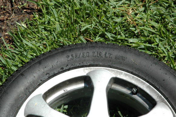

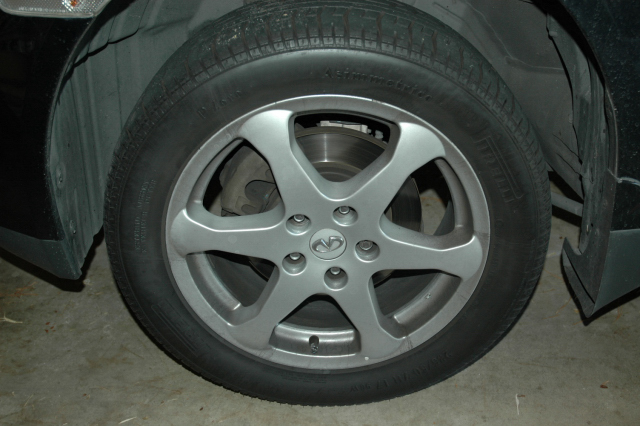

Yeah that means you have 17s. I didn't know the 6 spoke came in 17, but hey we learn something new every day. Hope the other info helps. I would not be surprised if the offset is right around 43-45mm, but the only way to be sure is to unmount the wheel and look on the back.

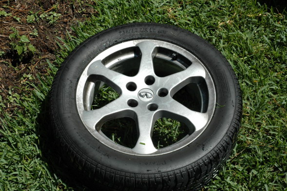

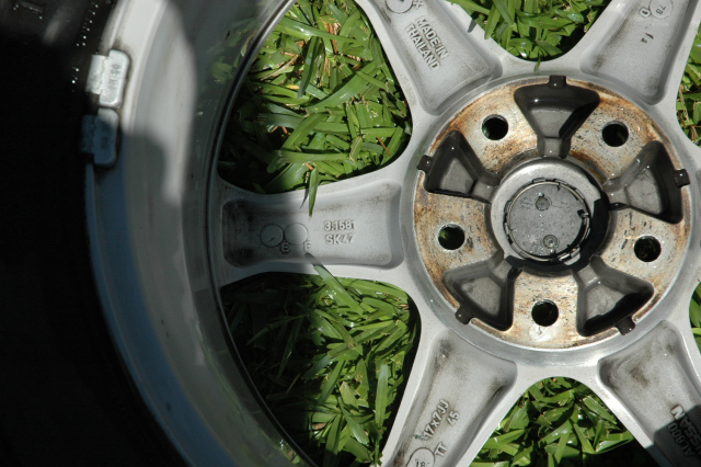

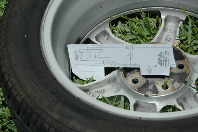

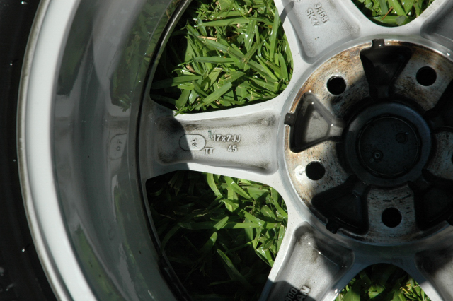

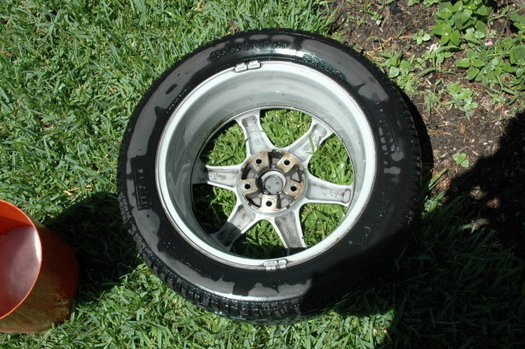

My wheel is off at the moment. will post pics soon. They have a 45 mm offset, stamped on the inside of the spoke. I'm planning on cutting the stop tech outline and trying a fit, but I see the print isn't exactly to scale.

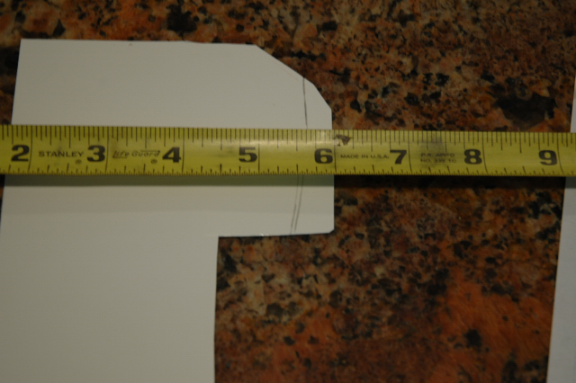

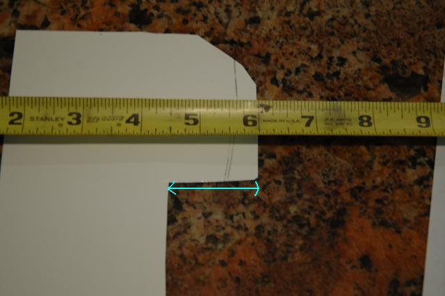

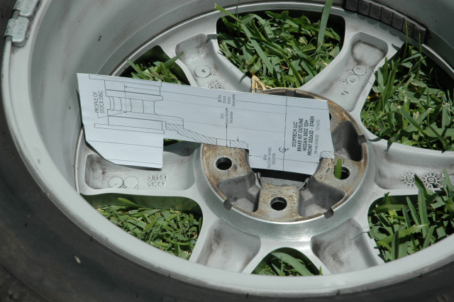

More pics and measurements:
I reprinted the StopTech measurement diagram in true scale.
It looks like I need a bit more than 1/2 inch!

Cato, I must correct my earlier post. A half in is actually 12.7mm not 6mm like i mentioned before, so my bad on that. 6mm is actually one quarter inch. A 1" spacer will give you 25mm and that's a lot. Not sure how much that overhang was on the picture you took, how far does it extend pass the spoke?, I would go with that plus 2-3mm more to give it enough clearance. When i measured mine, it barely touched the spoke and my wheel is a +42 offset, so i'm figuring a 5mm spacer will be more than enough for me. So far looks like for our vehicles +40 offset would work and anything less than that. Hope this helps.

based on the pic, and I know it's not to scale, I would say a 15mm spacer should be ok.

The last picture is with the outline of the spoke drawn on the measurement guide. It looks to be exactly 1/2 inch, so I would need a 3/4" spacer?

The 2003 Caliper and rotor. It seems to me that the fitment diagram ignores the rotor hat. If I included the width of the rotor hat, the fitment diagram probably would work.

Cato, I used that same ST-40 caliper stoptech cutout on my 17x8 +43 wheel. It barely touched the spoke. So I would need like a 5mm spacer if I wanted to use the Stoptech ST-40 caliper. So I'm not surprised your 17x7 +45 wheel does not fit. IIRC Dave@ArizonaZcar said that the Wilwood 6 pot Superlite caliper needs 1.5" inches from the rotor hat to the wheel spokes. See blue line in attached pic. I did the measurments on the stoptech cutout and that's the same amount, 1.5". So looks like you need at least a 15 mm spacer and most likely a 20 mm spacer. You will have to get the longer hub bolts as well like G35sedan03 mentioned. If you plan on tracking your car at all I would caution against using spacers that long and would recommend a different set of wheels with the proper measurments that will clear the BBK.
