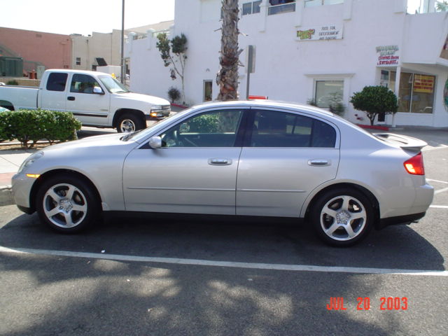

Dude, my bad I was out washing the ride. You may want to check your wheels because if I remember correctly, for the 2K3 cars, the stock 6 spoke wheel came in 16 inch, and if you upgraded to the factory sports tuned suspension, then it came with 5 spoke 17x7 inch all around like the ones in the pic below. I know those 17 inch came in +45 offset. The easiest way for you to tell the offset of those wheels is to look in the back, it is stamped on it, usually around the center or one of the spokes.
Now to replace the bolt studs, easy as pie. They are screwed in, so they unscrew out, you can buy them for less than a $1 a piece so roughly $20 will get you all of them to replace them. I would just have your local brake shop do it since they will need a good ratchet to take them out.
Attached Thumbnails 13.6" Wilwood BBK Installed in Piaa Super Rozza-car04.jpg
