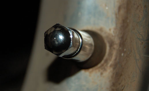

I am attaching a pic of the valve, I have a feeling that this is a cheapie valve that they installed. The base of the valve is rubber and flexible, there is a metal sleave that covers the valve, this actually came off when I was putting air in. I slid it back on, not sure if I did it properly. I don't see how I can twist or turn this valve. The tire is down 1 psi since I checked 30minutes ago, not sure if I can attribute to it still leaking with the cap on or just when I took the cap off to take the reading.

It's the core that is in the center when you take off the cap.

And the tool for tightening the valve core is very simple, only costs a couple of dollars.

Cool, some tweezers did the trick. Thanks a million guys.

Excellent, you should make a trip to Crappy Tire sometime and pick up a valve stem tool just to keep in your tool box. You never know when one will come in handy .
