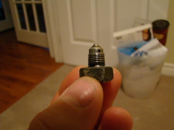

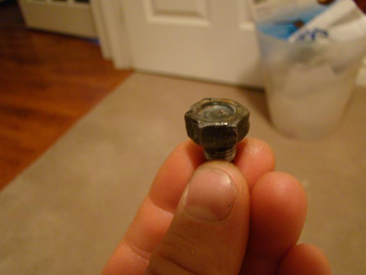

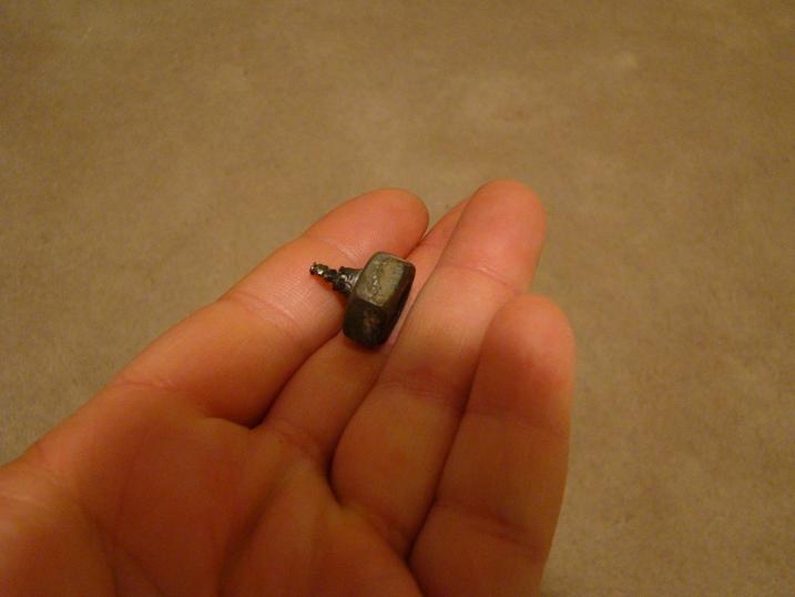

FU@KER came out. They guys at TAPP Auto in Ottawa were able to weld onto it and it came out. He first had to weld onto the easyout and get it out, then weld another nut on so he could drill a hole, fill it with weld, and then unscrew the nut. Took him about an hour and a half. I have new bleeder valves in it now, and I bled the lines. Everything seems good. No fluid leaks, pedal feels very firm, and panic stops don't have a mushy pedal feel. I held my foot on the brake for about 30 seconds really hard, and the fluid didn't drop in the master cylinder, so I am thinking I'm out of the woods.
Word from the wise, use anti-seize on your bleeder valves. What we think happened is that I tracked the car a couple of times at Shannonville and I only had DOT3 brake fluid in there and I had some serious brake fade and I'm sure the fluid boiled. The boiling probablly caused the bleeder to seize. Lesson learned, replaced with DOT4.
