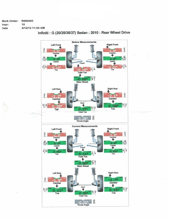

Alignment done.
Hey (Roy) I went and had the alignment done but at the Kitchener location. Looks like they brought all the toe within factory spec and the cambers are acceptable (to me).
Any comments?
Attached Thumbnails Looking good, Feeling happy :)-alignment-specs.jpg

Not bad, do you have a camber kit in the back?

No. Stock suspension with ProKit front/rear springs.
The stock rear camber is adjustable (to a point) however the front is not. I am going to keep a close eye on the front tires. I may get front camber arms.

See that's pretty close, mine is the same if not maybe a bit closer to spec but I wouldn't worry about premature tire wear with these specs.
