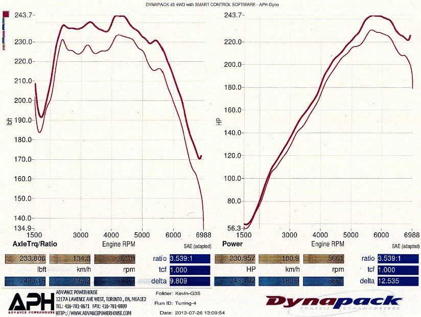

I decided to get Osiris and went with dyno over eTune to ensure I squeezed everything I could and to validate my results - and I'm kinda glad I did.
Mods on my 2007 G35 Coupe 6MT are:
- Mrev2
- 5/16 copper spacer
- Z-tube with Amsoil filter
Is a 230hp base with these mods "normal" and is a 13hp gain with a dyno tune "good"? (Note: One of the dyno pulls showed 244hp, hence why I'm rounding up to a +13hp gain).
Other than my results (attached) being OK, I'm also disappointed that when I inquired about an economy map and adjusting the throttle body (for better/smoother throttle response) he was not familiar with this and no adjustments were made.
The guy that did my tune was great and did seem like a very experienced dyno tuner with many different vehicles, including some previous G tunes that were on his computer. However after probably 2+ hrs and ~15 pulls I seem a bit disappointed with these results... should I be?

NYT,
I have the same model/year as yours and I would be dissapointed for sure.
I'm about to take the plunge and get a Osiris Dyno tune (not sure where yet) but at $700+ to get 13hp sounds insane to me.

You can get pretty much the same results from datalogging/ reflashing yourself at home with the $500 osiris standard option, plus you get the cable so you can reflash back to.stock later on if you.ever need to. I know a bit about this.. Feel free to pm me if you have any osiris questions

I was thinking along those lines too but I kept hearing that the Dyno tune method is way better than the datalogging one. But after seen that guy's dyno tune gains....I gotta say Im not impressed.
