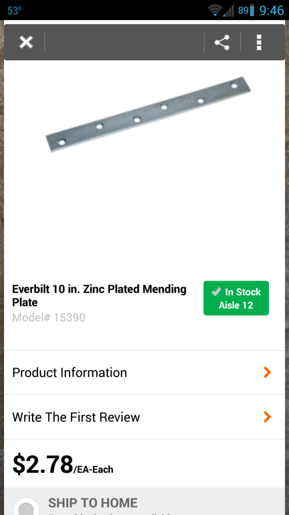

just did a quick search on home Depot app and found this.
So something like this could easily be made in to very sturdy bracket.
