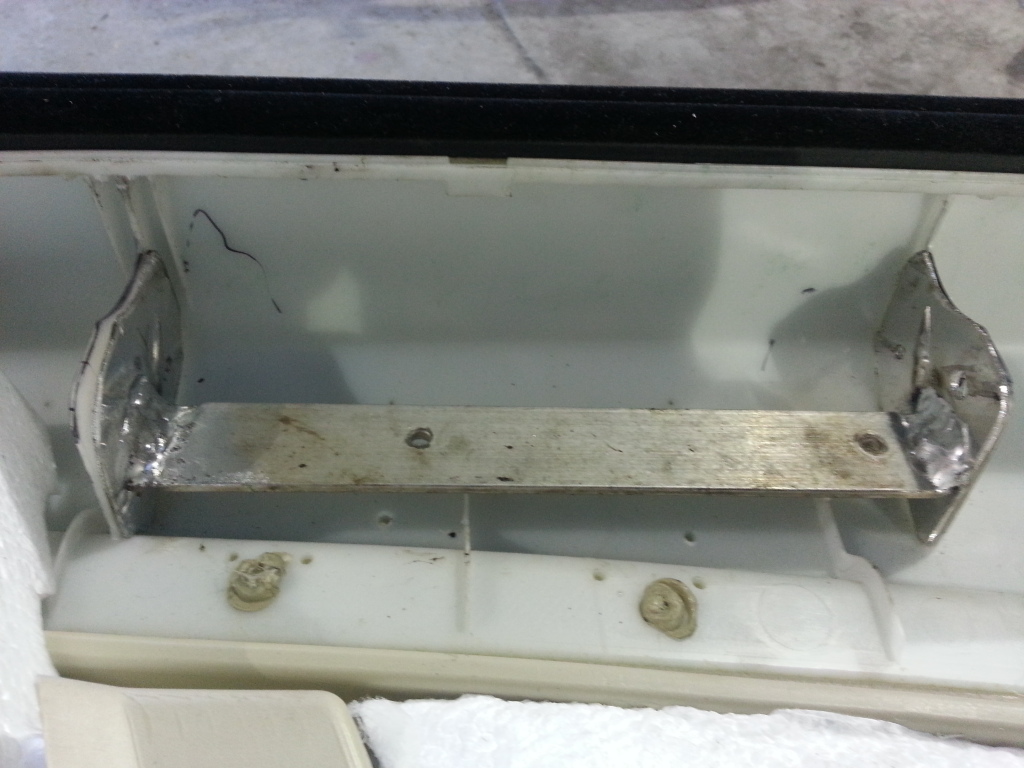

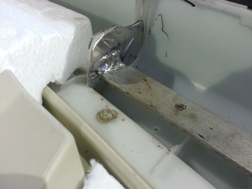

So the bracket that came with it absolute crap. It cracks and snaps when trying to bend it. So just like everyone else I needed to fabricate my own bracket in order to install it.
I obviously over engineered it.
On the other hand, I think you could find something at your local hardware store to fabricate bracket out of to make install simpler and not go all ***** out like I did and tig weld it.
I'm pretty sure that in case of nuclear explosion cockroaches and my bracket will be the only things that will survive.

Looks solid for sure. You happy with the fix?
