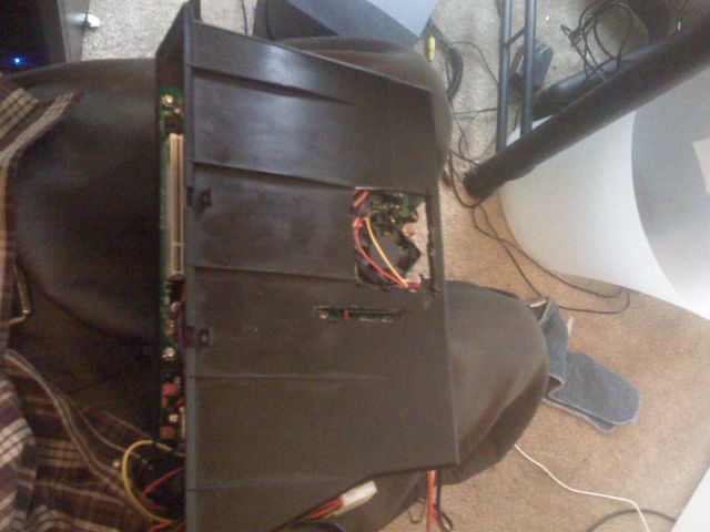

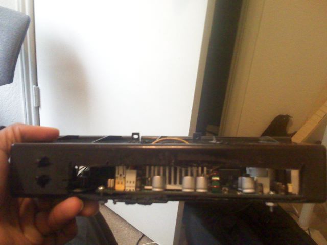

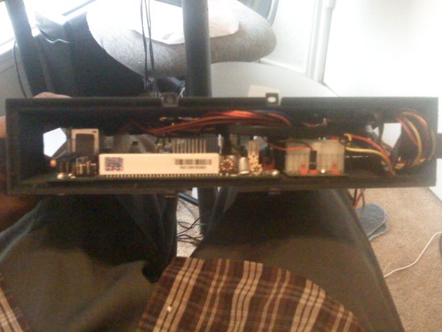

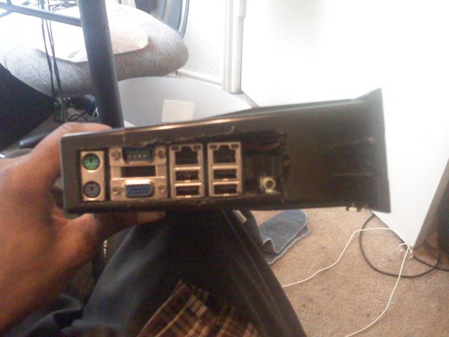

Mobo, power supply, and hard drive mounted!
It's been a bit of delay with easter and other stuff coming up but I'm finally nearing completion. I got my reverse camera in and got everything mounted in the upper storage compartment. I fit a mini itx mobo, m2 atx power supply, and a regular 2.5 laptop hard drive with a bit of dremel work. Barring no issues I should have everything put in by this weekend.

That's great man! I have mine put in and running but I didn't dremel enough space for all of my ports.. so the sound plug is being squeezed out. I'm only getting sound from one side.. so I'm going to try and replace that with a smaller cable. It's definitely a tight fit back there and almost wonder if I should've just installed it in the trunk by the bose amp in that space. The rear view camera is nice coming out of reverse though.
