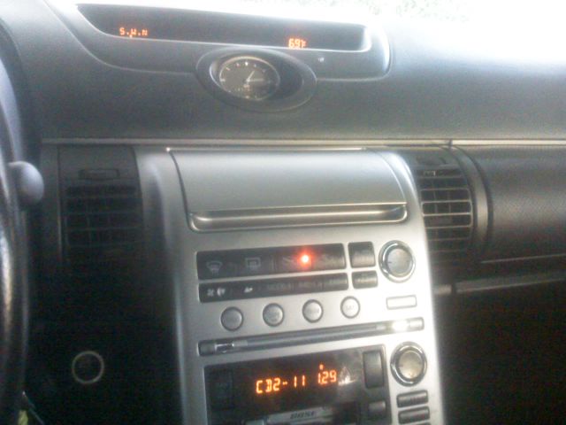

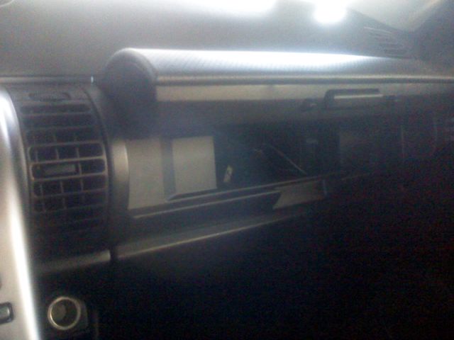

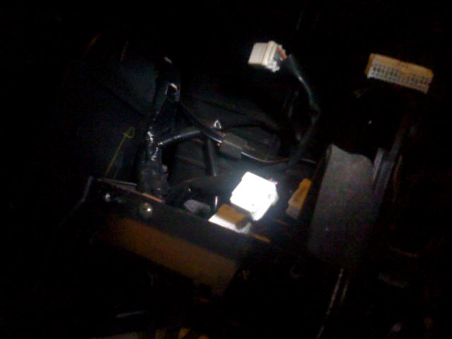

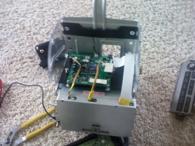

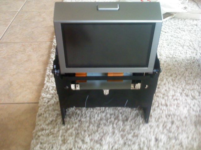

Just a quick update.. I got the navigation taken out and touchscreen put in. I plan to put the actual pc in next weekend as long as I can get everything mounted correctly in the compartment on my test bench. Here are a few pics of everything. Oh and I found a few video links that were a HUGE help.
http://www.infinitihelp.com/diy/gcou..._procedure.htm
http://www.infinitihelp.com/diy/gcou...dure_video.htm
Attached Thumbnails 04 G Carpc Worklog-img026.jpg   04 G Carpc Worklog-img027.jpg   04 G Carpc Worklog-img028.jpg   04 G Carpc Worklog-img029.jpg   04 G Carpc Worklog-img030.jpg

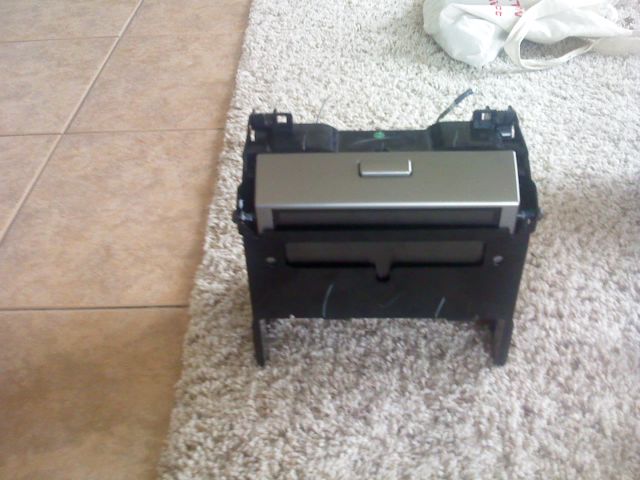

Additional pics
My digital camera is nowhere to be found so I had to use my treo's camera which sucks. Here you go though
Attached Thumbnails 04 G Carpc Worklog-img031.jpg   04 G Carpc Worklog-img032.jpg   04 G Carpc Worklog-img033.jpg

ah nice. so your going for the oem style screen that pops up eh? Looks good so far. How long do you think it took to do just this part?
Old Mar 29, 2009 | 08:08 PM
b3tts32's Avatar
Posts: 58
From: DFW
Yeah it comes out manually but I like it because it can be concealed. Yesterday it took me about 6 hours by myself to take everything out and get things swapped out. I ran into some hiccups and got snagged on some stuff so that's why it took so long. I ended up forgetting to re-connect a ribbon so I had no radio/ac so I re-did that today and took everything back apart and it only took 30 mins. Once you get comfortable with it it's a pretty quick process.
