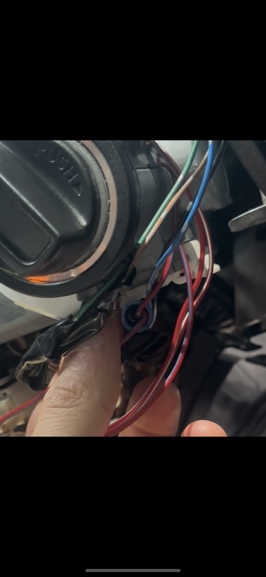

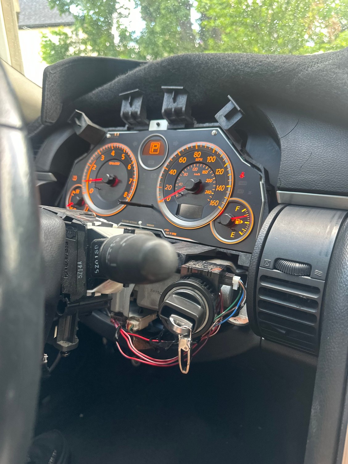

I could never get the valet key to turn the ignition until now, somehow these blue and red wires were broken i had torn apart the cluster because i thought it was the NATs antenna but i started looking around and with a multimeter i tried to get continuity to the steering lock
And when i prob the point the FSM said to it started to short out the circuit and unlock the steering lock and i was like What!?? So then i looked around more i noticed theses wires were broken i had no idea what they went too but i hooked them back up really quick and put in the key and BAM it turned over the engine. I was in awe because ive been chasing this for a couple of months and taken it too several people and spent so much money trying to get this fixed. I thought i had a bad bcm or ecm and trying to get keys programmed it would never progam them. I think these wires are the signal to say “OK” the car can turn over.

Thanks for letting us know what the fix was!
