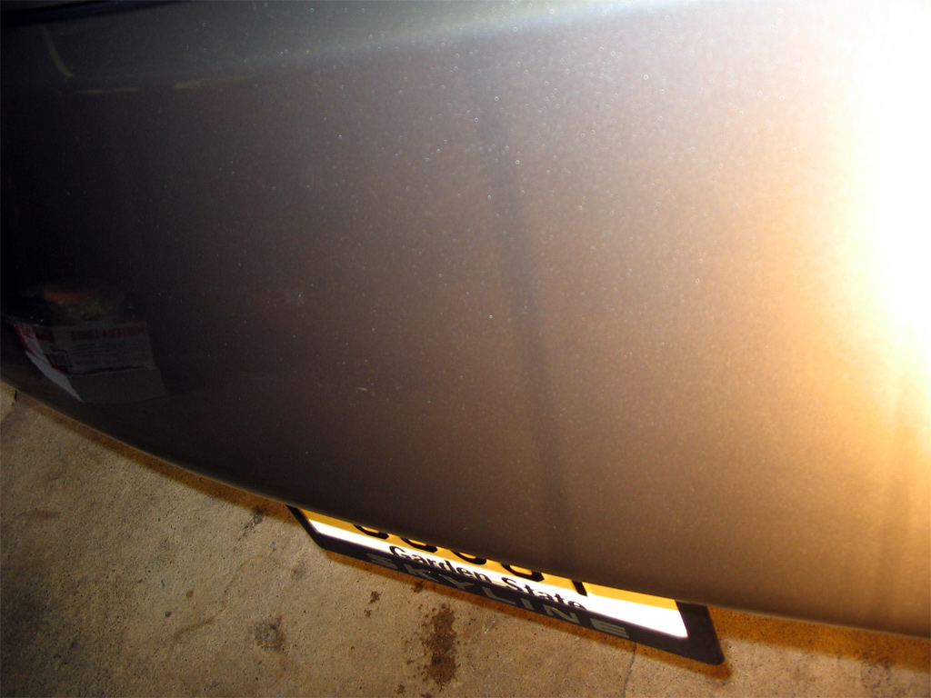

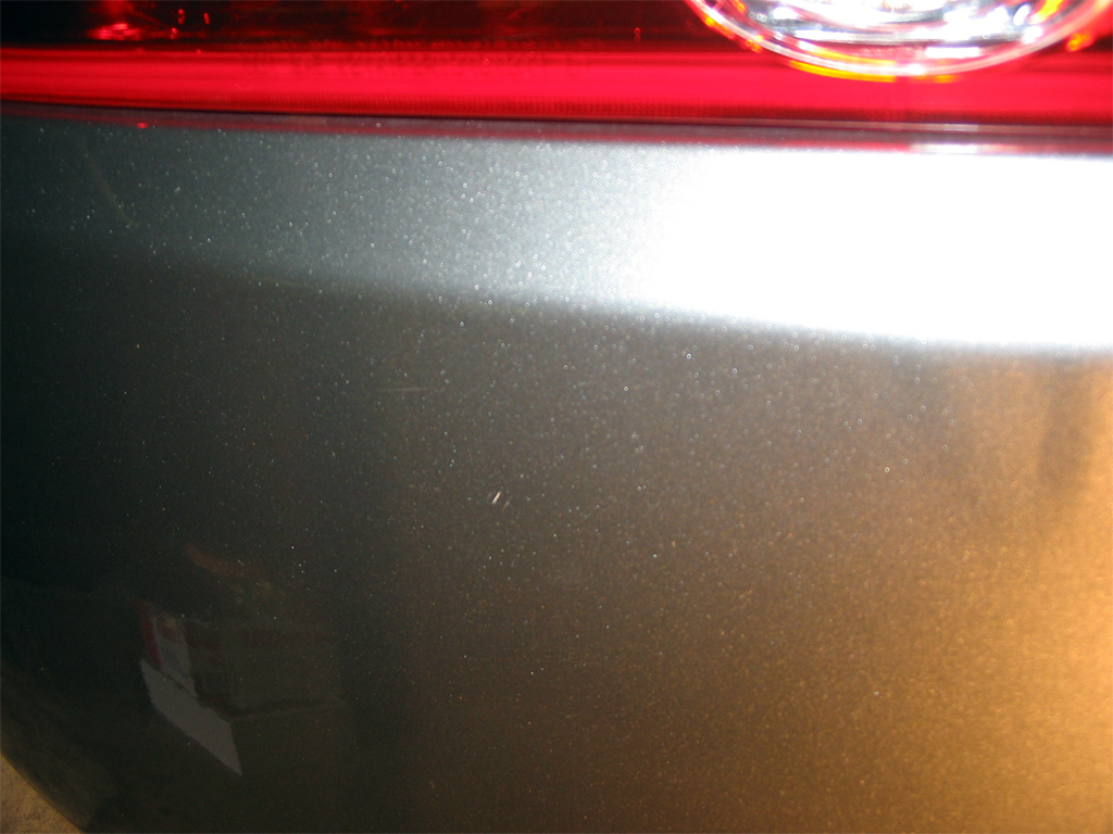

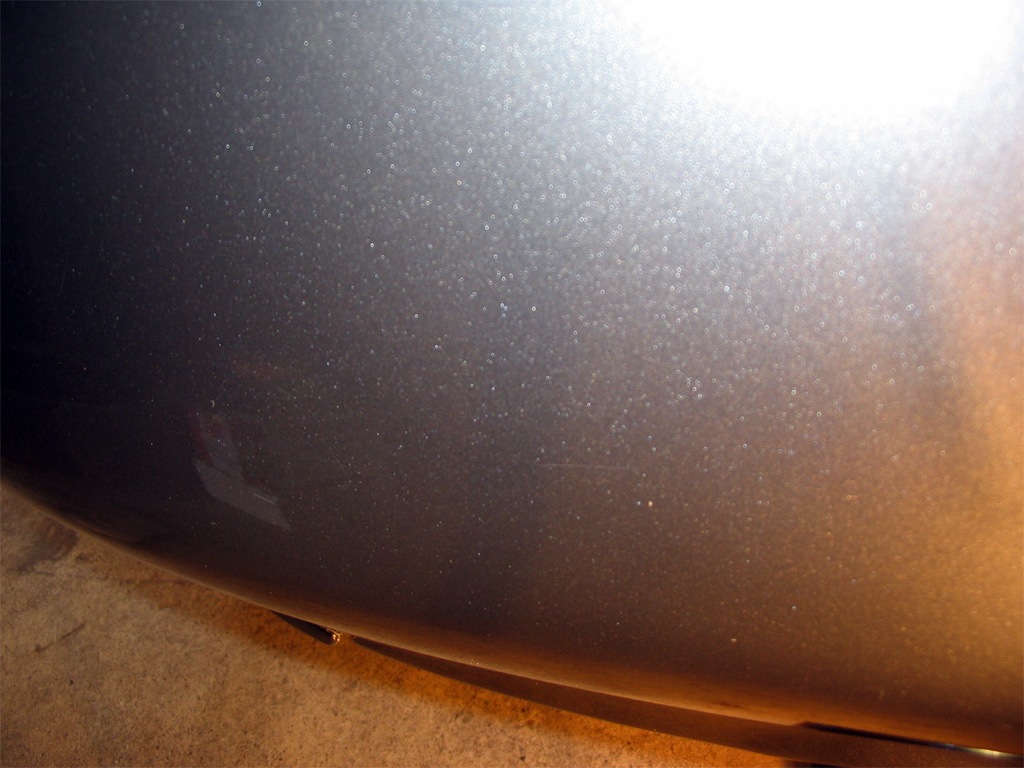

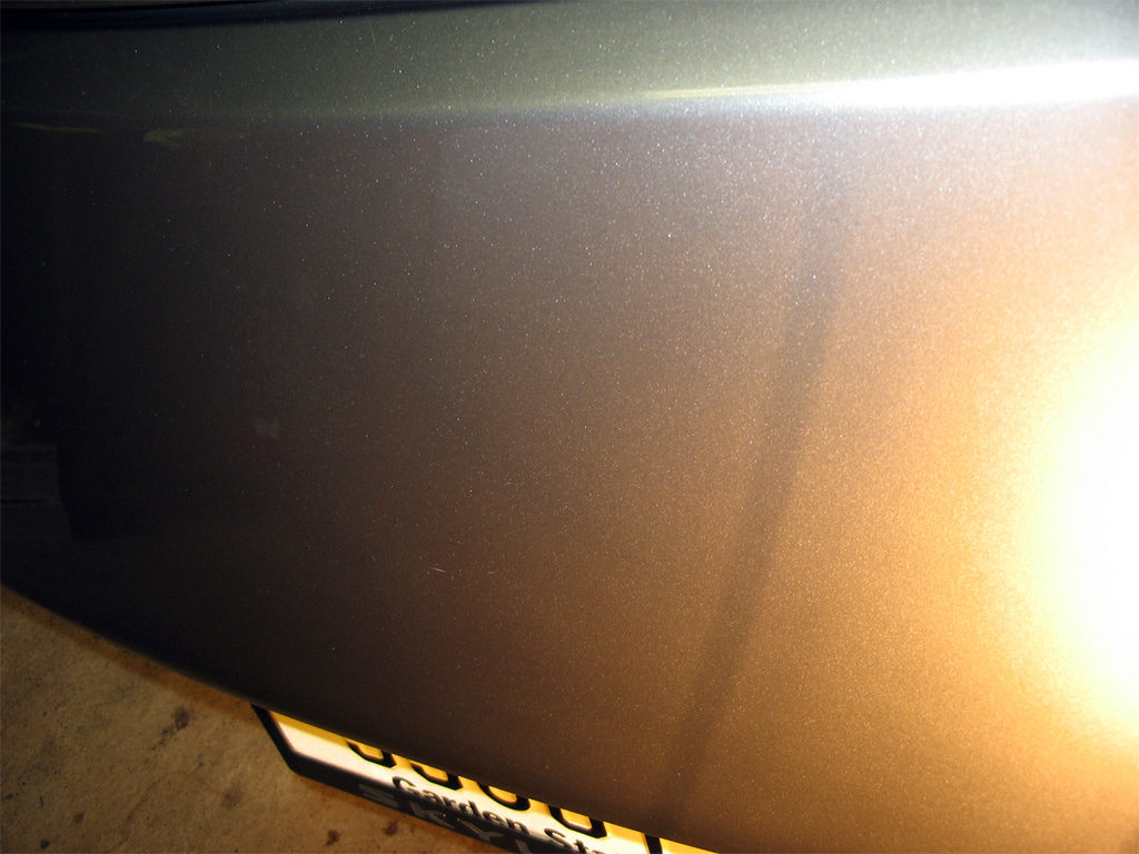

So I have detailed a few guys car here (G'Dup13, Jadas) and decided that I finally had some time to do my own car.
3 Months ago I had Detailed the car by hand using the usual products (Claybar, Glaze, Wax).
Well I knew I had some minor scratches here that were visible and some that weren't. I wanted to test this wax I been hearing that is pretty good as far as longetivity.
Here are some pics after washing the car with Dawn and Claybaring the car.
Attached Thumbnails Scratch Removal-before.jpg   Scratch Removal-before1.jpg   Scratch Removal-before2.jpg   Scratch Removal-driver-rear-bumper-scratch.jpg   Scratch Removal-driver-rear-bumper-scratch2.jpg

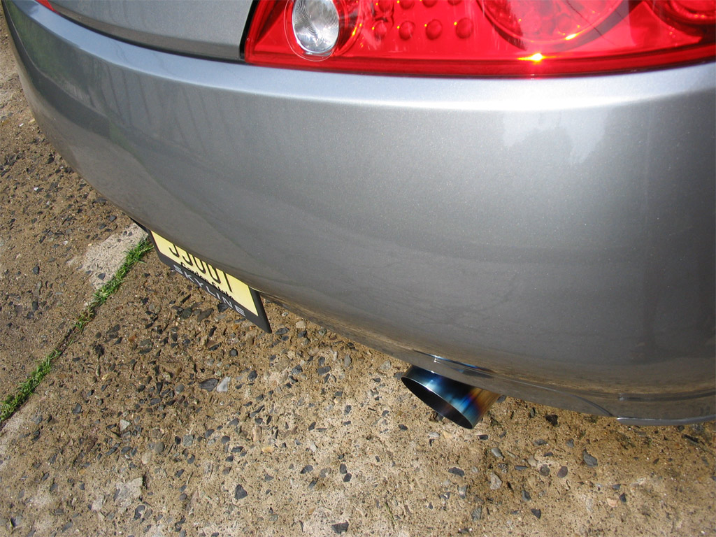

Here are some of the other scratches
Attached Thumbnails Scratch Removal-mid-rear-bumper-scratch1.jpg   Scratch Removal-mid-rear-bumper-scratch.jpg   Scratch Removal-pasg-quarter-panel-scratch.jpg   Scratch Removal-pasg-rear-bumper-scratch.jpg

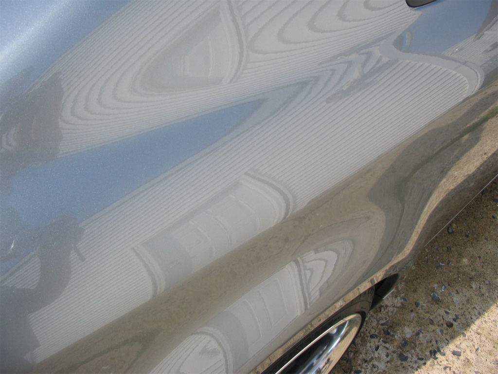

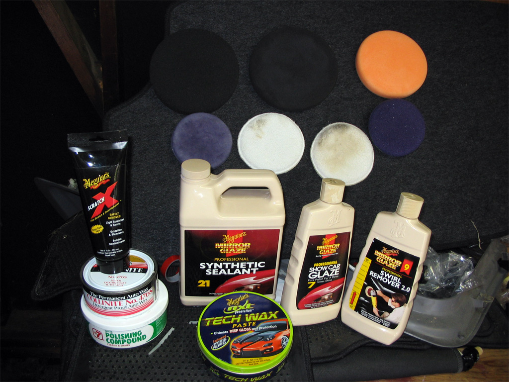

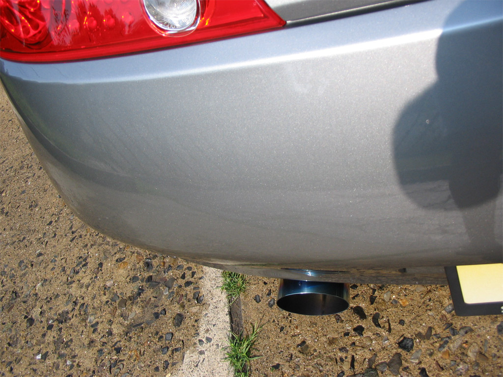

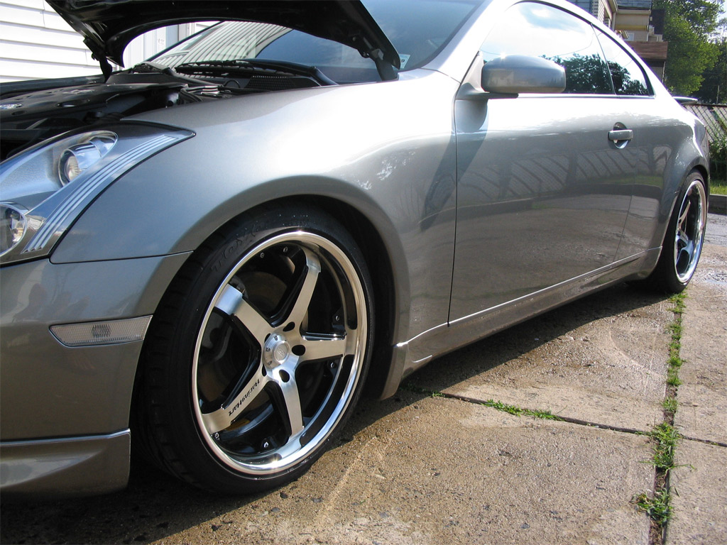

Well after 8hrs with the PC and these products I got the job done.
With DG its hard to capture the scratches that the car had.
I thought I was done with certain panels after putting glaze and had to go back over it with swirl remover.
I did not use the compound since the scratches I had were all superficial and I tried not to use swirl remover on all the panels just the ones I thought that needed it.
Well I'm totally satisifed with the finished product.
I'm even testing Collinite 476S super wax suppose to last a long time, so we will see since this detail has to last until after winter. I topped it off with NXT at the end just to give it a little more shine since the Collinite is a little on the dull side.
Attached Thumbnails Scratch Removal-products.jpg   Scratch Removal-after.jpg   Scratch Removal-bumper.jpg   Scratch Removal-driver-bumper.jpg   Scratch Removal-driver-front.jpg

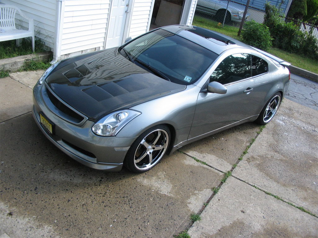

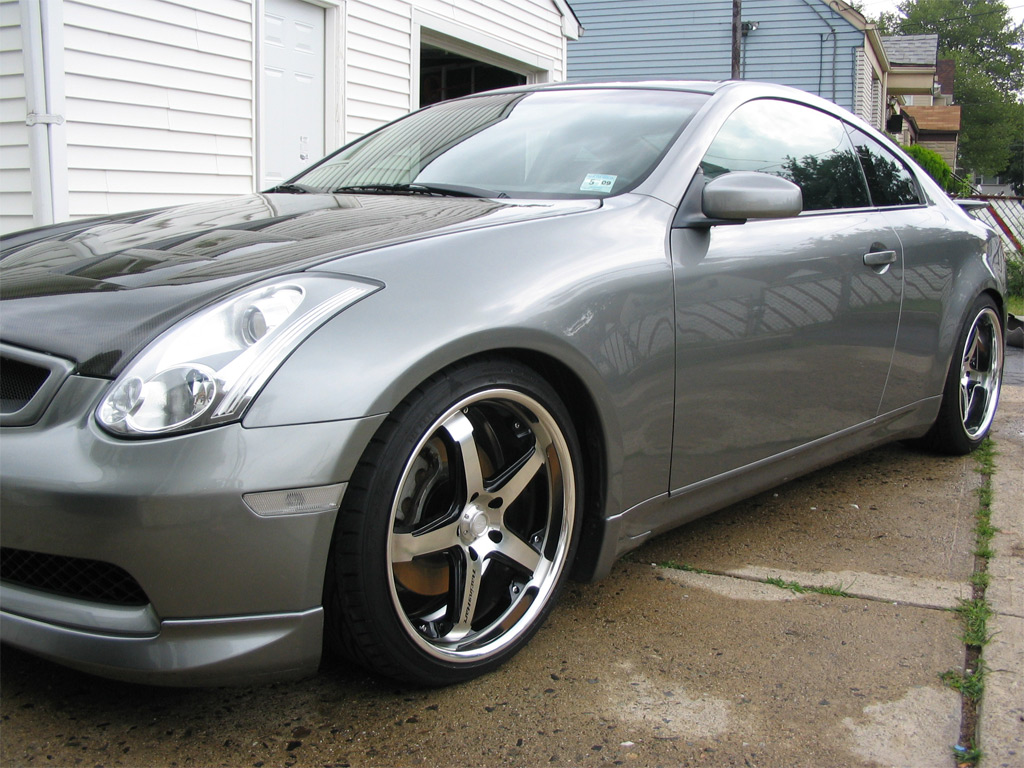

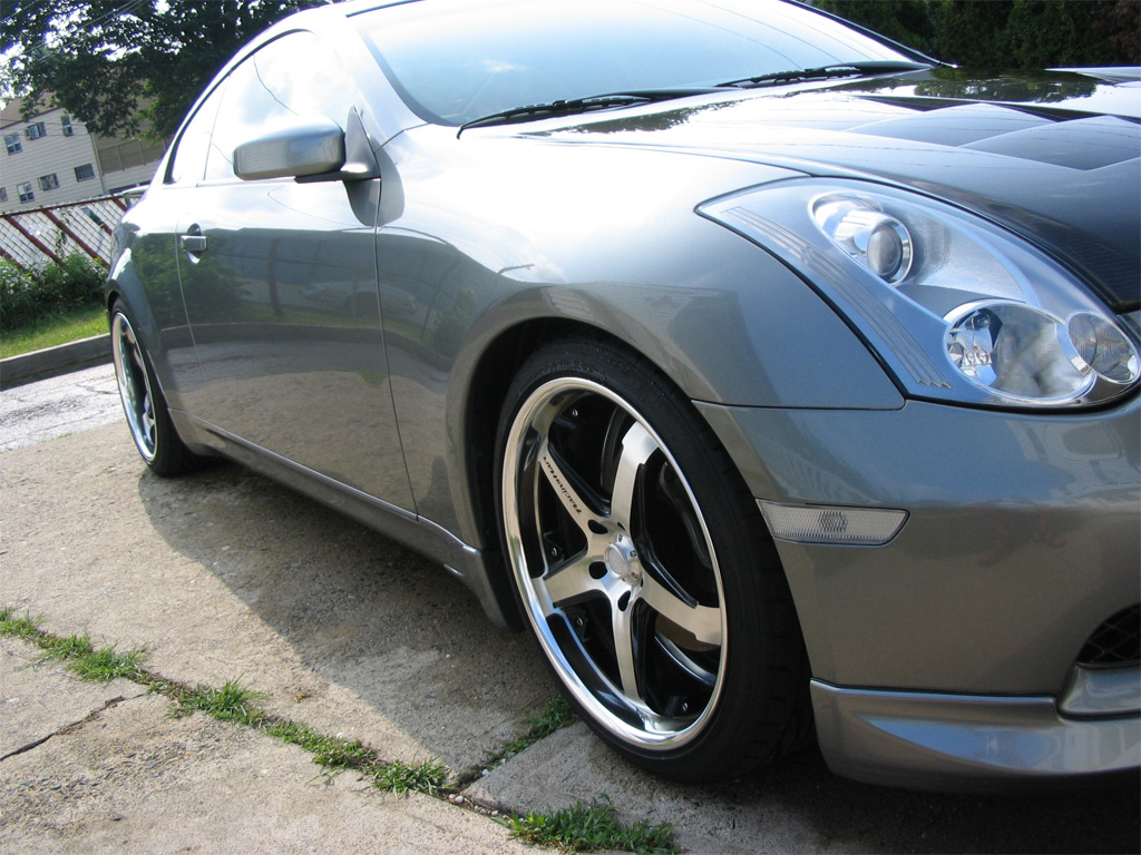

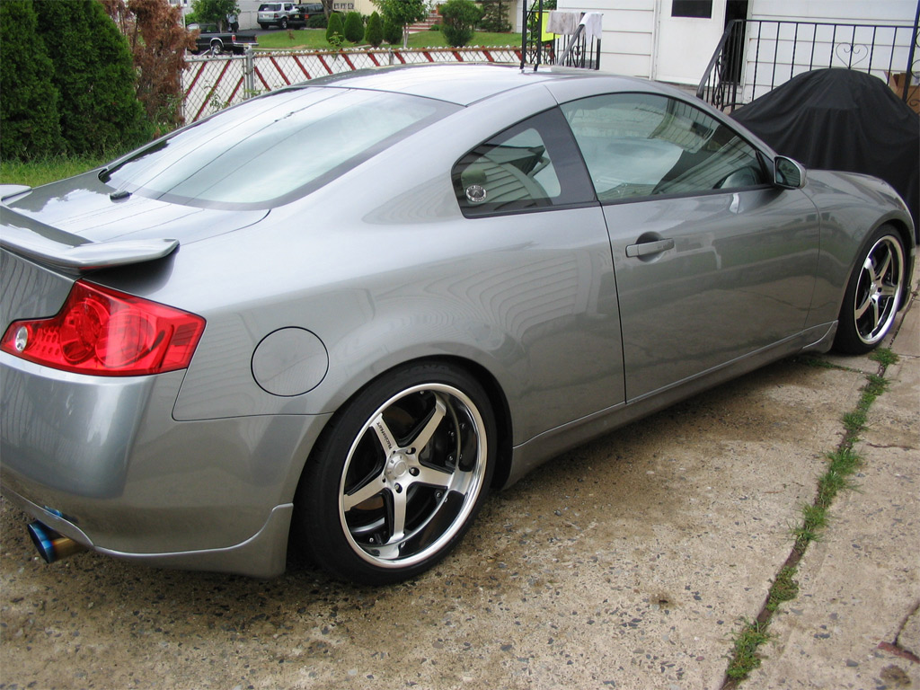

last pics
Attached Thumbnails Scratch Removal-driver-side.jpg   Scratch Removal-hood-shot.jpg   Scratch Removal-pasg-quarter-panel.jpg   Scratch Removal-passenger-side.jpg   Scratch Removal-passenger-side-front.jpg
