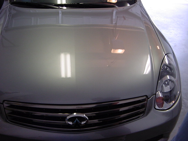

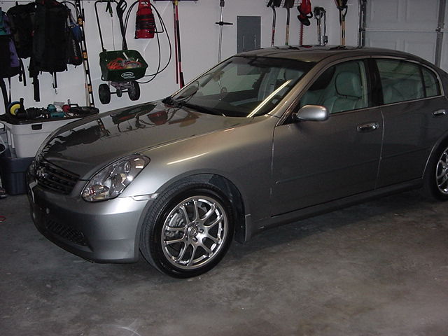

Pics of first detail job using new PC 7424
I've been detailing by hand for a long time but I decided to step up to the PC. Since the car is relatively new, I decided that I didn't really need to use a true polish. Here is a list of the products used, in the order that they were applied:
1. Washed car with Dawn liquid (I try not to do this very often).
2. Applied Meguiars #7 Show Car Glaze with the PC, removed with microfiber towel.
3. Applied Meguiars #21 Synthetic Sealant with the PC, removed with PC using micro fiber bonnet over clean finishing pad.
I haven't decided if I want to put a 2nd coat of sealant or a coat of Meguiars #26 Hi-Tech Liquid wax. The PC was fairly easy to use and the car is definitely brighter and smoother than if I had used my hands.

the pc isn't really needed for applying any of those products, you should pick up a fine polish which will benefit even new cars such as menzerna intensive polish or optimum polish. Then apply #7 and #21 by hand instead of by hand to save product

ooo it's glistering

Looks great...My dg has a ton of light scratches that I need to get out...I think the pc w/scratch remover might be the solution.

nice and shiny........Very good
