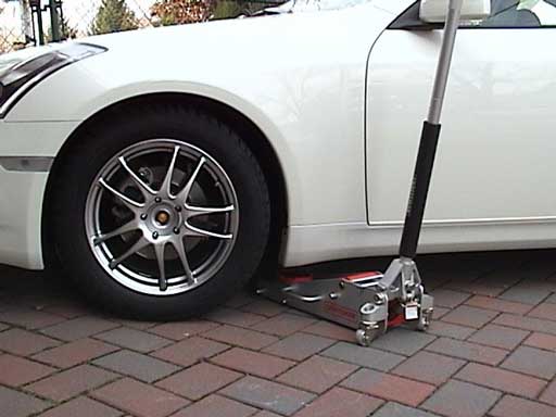

I bought a jack at SEARS a couple years back when I bought my winter tire/rim set up.....
The one I purchased is a low profile style, and it fits under the car quite easily. I think I paid $150 with a couple of coupons/discounts.
Attached is an old pic I took when I first put on my snows. This will at least show you the profile next to my car.
