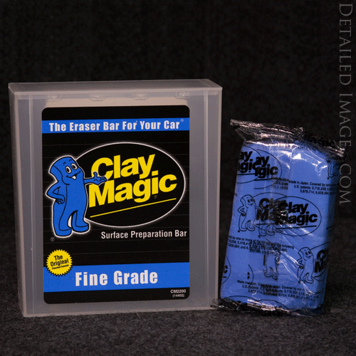

I clay as needed or before a polishing session. It usually ends up being 2 ~ 3 times per year. Using a milder clay bar will be less likely to add swirls or micro-marring, where a medium grade or heavy duty clay will often leave marring behind that needs to be polished out. If you maintain your car on a regular basis, always stick with the fine grade bars. If you have paint overspray (or something similar) then using a medium grade bar can increase the speed of removal, but plan on polishing afterwards.
