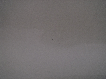

Ok guys, here is the pic as promised...I really don't know what anyone can make of it, but it's a close up shot of the hood. If someone wants a sharper version, I will try to take one.
I found a small speck that I cannot remove on the hood.  Any suggestions?-dsc01342.jpg

I'd definitely try clay on that. I don't see any distortion of the clear around it, so I doubt it's a rock or a bug that got lodged into the clear. It could be a factory defect but those are pretty rare. If clay doesn't do it then try Punchits suggestion of a mildly abrasive polish (ScratchX is ok if you want to get something locally).
Attachment 33847
I had some thing similar on my DG. I tried some mild polishes, then to a rubbing compound, then to wet stand, and then to ...primer.
If you're at all new to using these products, just be careful, I ended up getting the door repainted to the tune of $500. Good luck.

I don't know why clay works the way it does. I really should, considering the amount of cars I use it on - I just know it works. It isn't a miracle or anything, but I've used it to take off totally hardened tree sap, rail dust that has embedded itself into the clear, overspray, spray paint, you name it. Even if it doesn't work it won't harm the paint in any way and you'll only be out $10. ScratchX won't hurt the paint either.
If neither of those do it I'd say it's probably a paint defect and would bring it to the attention of the dealer.
