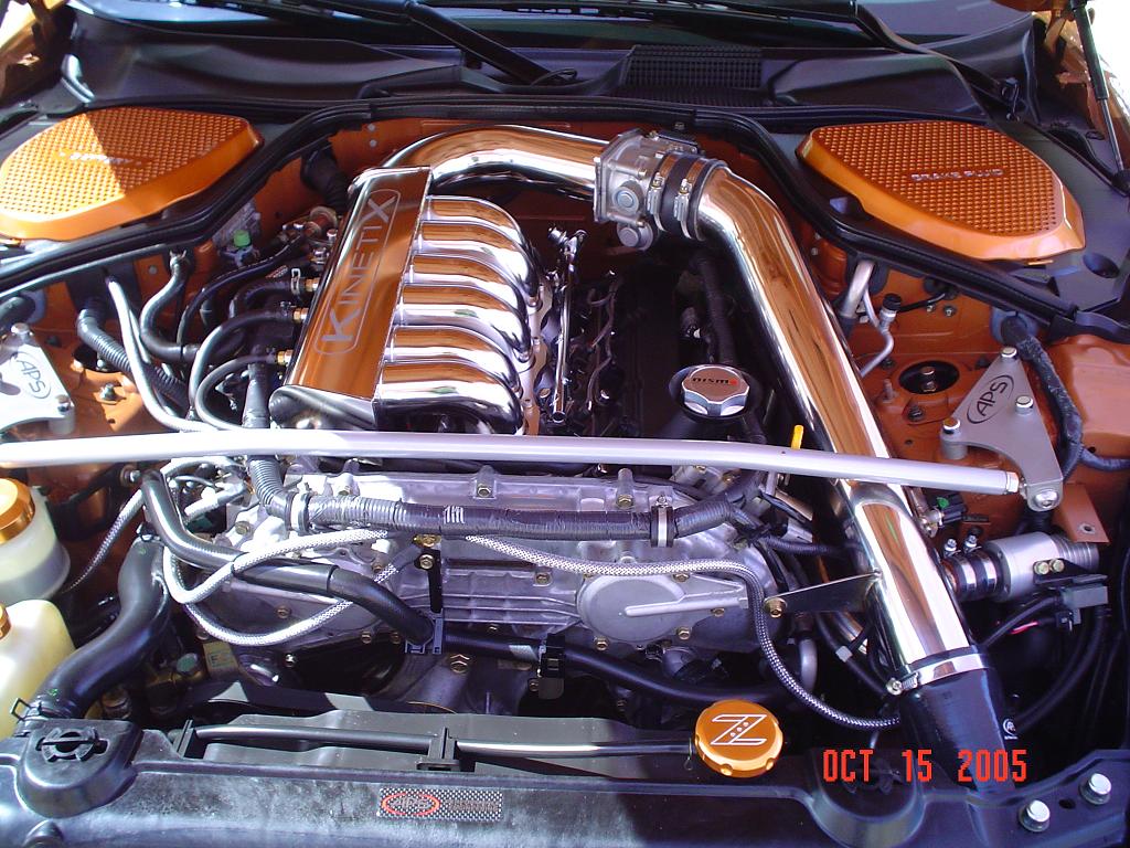

Last Monday I had the 1/2" spacer with ISO Thermal Kit installed at Velocity, just before I went into work. Friday I hit the dyno on my way into work.
I gained 14.69 HP and 17.42 FT-LB
https://g35driver.com/forums/showthread.php?t=71191
The Kinetix plenum replaces top and bottm. I think it's in the $750 range.
https://g35driver.com/forums/attachm...7&d=1129429374
