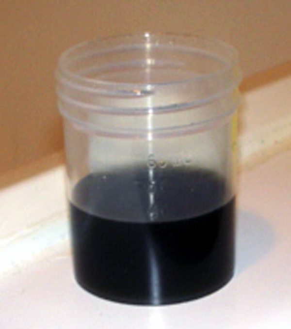

The issue with fluid in the clutch hydraulics on 97-07 GM cars, and maybe on your Infinitis, is heat. If you drive aggressively, the fluid degrades quickly and loses it resistence to boiling.
Easy way to tell is by the color of the fluid. If it is crystal clear, same color as in the can, then the fluid is OK.
If the fluid is murky, follow the procedure on my site and return the fluid to a clean and clear state. Taking Care of Your Clutch: the Ranger Protocol If you do that you will probably return to having a normal pedal again.
To get dark clutch fluid in a GM LS1/2/6/7 clean again can take 10-15 changes of the reservoir. That cost about $10 for the fluid and a syringe. Cheap way to banish pedal woes; good preventative maintenance measure too.
Added a couple pics.
That dark fluid is the prescription for pedal woes.
Fluid should be clear (zero murkiness).
The syringe is the one I've used for six years, available at Walmart.
On my clutch care page is a link to a list of the best brake fluids available. For my C6Z06 I settled on Prestone DOT4 Synthetic because it's widely available and not expensive. Plus I change mine frequently.
Remember, pedal woes aren't cured by one change of the fluid. You must keep changing it until it remains clear after agitation by 20 pedal pushes.
Hope this info helps you guys get those clutch pedals back to normal and keep them that way.

OK here we go,
So I went to Pep Boys and picked up a can of Valvoline Syn Power Brake Fluid, DOT4. Then I went to target, saw that they wanted $9 for a turkey baster, and got a $2 syringe thing instead.
Upon opening my clutch reservoir I found this sludge.
Yeah, obviously needed to be changed. So i took my huge syringe, and sucked up as much goop as i could get and it looked like this
I did find out that i didn't need the little needle thing you see there so i took it off and was able to do the rest of this without it.
So I cleaned out the reservoir with a no lint cloth
I couldn't get that little part in the bottom, but the whole thing was that color, it was gross.
Then I took this stuff here
and poured it in. Almost instantly it started turning to a nasty color;
I put the cap back on after I gave it a good rub down with the no lint cloth, got in the car and pumped the clutch pedal about 25 times.
When I got out and removed the cover I found this;
hmm, so i did the drain thing again with my syringe, filled it back up again, did the pumping thing again, and got this;
ok, not quite clean. did everything again and got this;
decided to go for it just one more time and got this
and just for good meausre i did it again and got this
and that was clean enough for me.
I'm going to need to do some driving to see how this stuf reacts, if anything, it had to be the fact that the stuff that was in there was 30k miles old and needed to be replaced anyway.
Hope this helps everyone.
