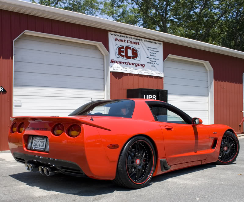

I'd be impressed if you could even fit a jeep tire on there. If you jacked the back up 6 inches, your car wouldnt even be driveable. VDC would be the least of your worries.
I do not know of everyones tire combinations on here. Personally I ran 245/30/20 and 285/30/20 for years without a single issue (tried a 305 but couldnt fit it on the car). A buddy of mine ran 275/25/19 and 325/25/20 on his Z06. Nearly 7% difference and not a single issue. At the meets, I have seen several C6 guys running 345/25/20 rears.
Problem is, you are starting with an arbitrary value (3%) that you have no idea if is even valid. Then you are trying to apply it to a G35, which you have no idea how their VDC is programmed. Guess however you want, in the end you still will never know.

Looking at the tires sizes posted by WhosUrBuddiee, he ran with a 3.7% difference on his G. His friend with the Z06 only had a 3.9% circumference difference (not 7%), but it's irrelevance because it's a Z06, apples to oranges comparison.
