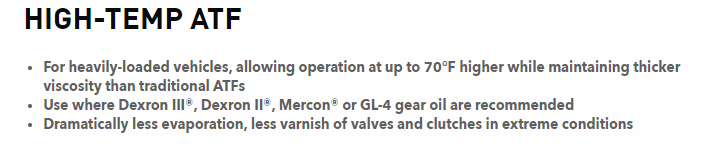

Guys, thanks for replies! But what do you think about ATF with such properties:
As I understand, it will be more pressure inside tranny with the first one under 100°C, am I right?

So a little update. My transmission is ready and already installed. It was found during installation that AT cooler was ALREADY installed. So my hopes for additional cooling were broken. Idemitsu Type J (which is Nissan Matic J) was used as ATF. Not Nissan Matic S because I found that it was used in the past when tranny broke. Now I'm waiting for answer about high temp ATF which is described as

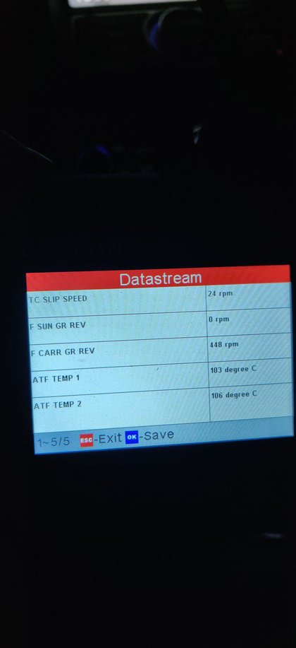

Anyway, any suggestions still would be helpful because here is ATF temperature after several non-agressive accelerations 60-250 km/h (outside temp was near 15°C or 59°F)

Honestly it's not overheating so... I mean it's at sort of the high end of where you want the fluid temp to be but considering the mods it's not terrible, just decrease your fluid change interval to 15-20k miles. You should add a temp gauge so you can watch it in the future though. Also, how big of an aftermarket cooler does it have?
The stock fluid temp probe is up inside the transmission, I suspect it's going to read a little hotter just because of where it's installed. See if some other users can post their transmission fluid temp to compare.
There's also nothing wrong with adding a second tranny cooler in series with the first, done it before on track cars using powerglides that needed the extra cooling but didn't have much room to install a bigger cooler.
