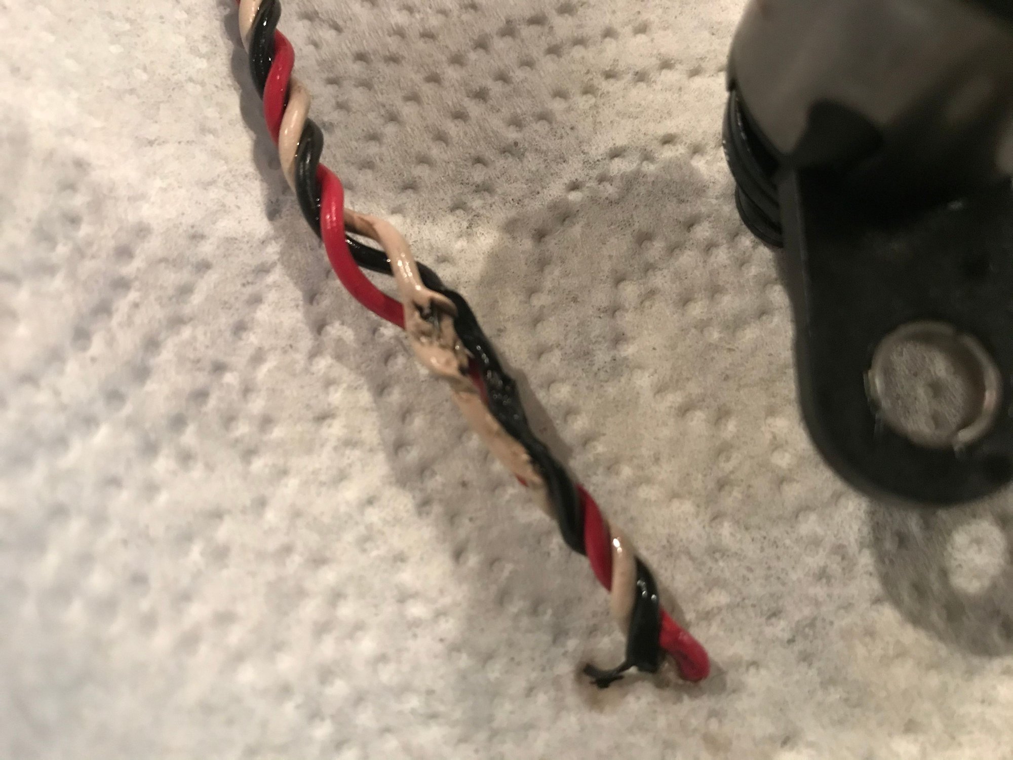

So the plug I referenced before hand wasn't the case. I planned on checking if it was the solenoid causing me not to be able to move while in drive or reverse, but I came across another variable. The wire could have possibly been frayed upon re installation the first time. So now ultimately I will have to drop the valve body after this second time.
Both of the solenoids have all identical numbers except for the ones on the top. The new one says 1361 while the old one says 1261. And I'm unsure what those top numbers in date format are, as my old one says 03-03-19 and the new 03-08-13
So once I rewire this plug I will be putting the old solenoid back in to see if my drive and reverse issues were because of the new solenoid.
Link to solenoids I purchased:
Car Transmission Control Solenoid... https://www.amazon.com/dp/B07VDCNJCN?ref=ppx_pop_mob_ap_share
And btw the wire was detached because I forgot to unplug it the second time I dropped it... So I mean the cut (end part) and damage (after the cut) could have happened on different instances.
