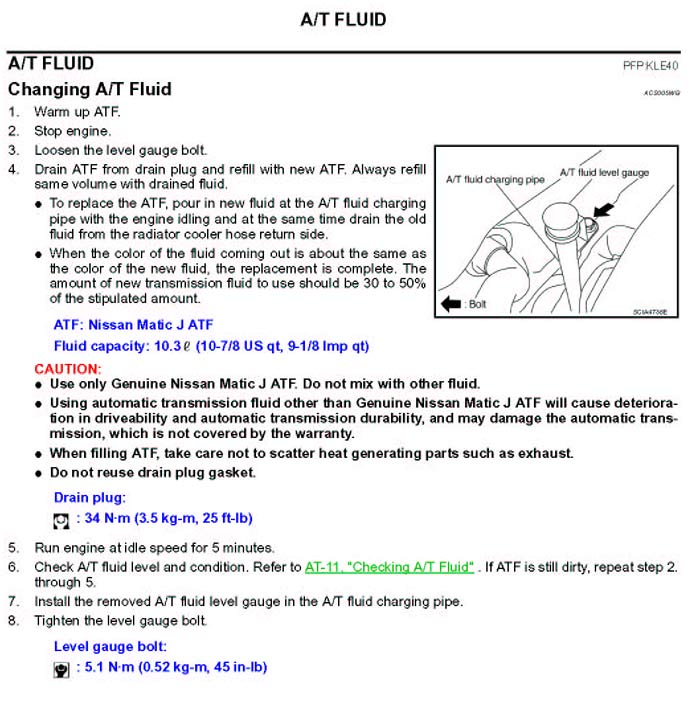

Proceedure from the manual

Thank you for the manual. However, I thought the flush is probably more thorough than the drain and fill as show in the manual. Don't you think so?

Based on your description of how flush is done, it sounds a lot like the procedure described in the manual posted by inTgr8r above. If you read it carefully, they are telling you to "pour in new fluid at the A/T fluid charging pipe with the engine idling and at the same time drain the old fluid from the radiator cooler hose return side".
However, when I was talking to one of the dealers, he sounded like they use a special eqpt to "power flush" it. Anyone know what that means?
The "special eqpt" is a closed-loop system that they tie into the lines going to the trans cooler up front. It sucks and pumps at the same time like a good girl. The same amount of fresh in as it sucks out. And it swallows too so no mess.
