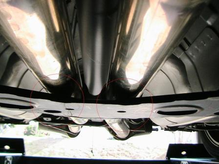

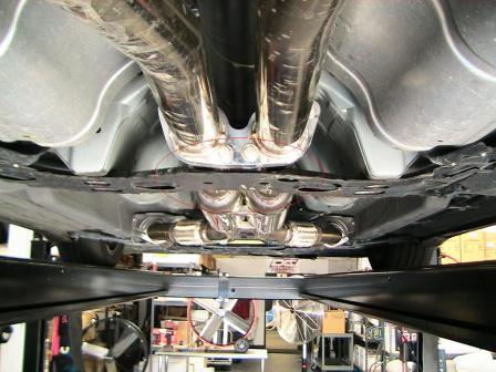

I had the exact same situation, and it drove me absolutely nuts. It was definitely worse when the engine was cold (I'm sure I was really popular in the morning in my neighborhood).
A month or two went by before I did anything about it (just between work and family), and then I finally brought it back to the shop that installed my exhaust, Advanced Motor Sports in Lake Forest, CA. I realize I have stated this previously on this site, but the customer service and quality of work provided by Mike Shapiro and his team is top notch.
The exhaust pipe and the frame support were rubbing as seen in the pictures. I believe the solution that AMS configured was a dampener between the exhaust pipe and the frame support.
Can you guys with the rattlers take them back to the shops that worked on your cars?
Attached Thumbnails rattling heat shield ?-img_0124.jpg   rattling heat shield ?-img_0125.jpg   rattling heat shield ?-img_0126.jpg
