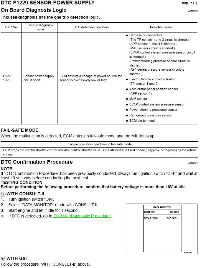

Turns out the P1229 was a stored code from previously. Cleared the codes and there's no codes.
Car still doesn't get a spark signal though

That code covers a lot of different sensors. You need to follow the diagnostic procedure to figure out which one is bad...
DTC P1229, elaborate-1229_1.jpgDTC P1229, elaborate-1229_2.jpgDTC P1229, elaborate-1229_3.jpgDTC P1229, elaborate-1229_4.jpg

Ok, here's the thing, this is an 05 so it may not be the same code. I have the TSRM for the 06 and code P0643 is the sensor power supply.
So now i'm wondering if the P1229 for the 05 is the same or not. Considering all the DTC lists we have on here show nothing of the P0643. So does anyone have the code list for an '05??
Thanks, for the link above, thats exactly the same stuff i have in my manual but for the P0643.
